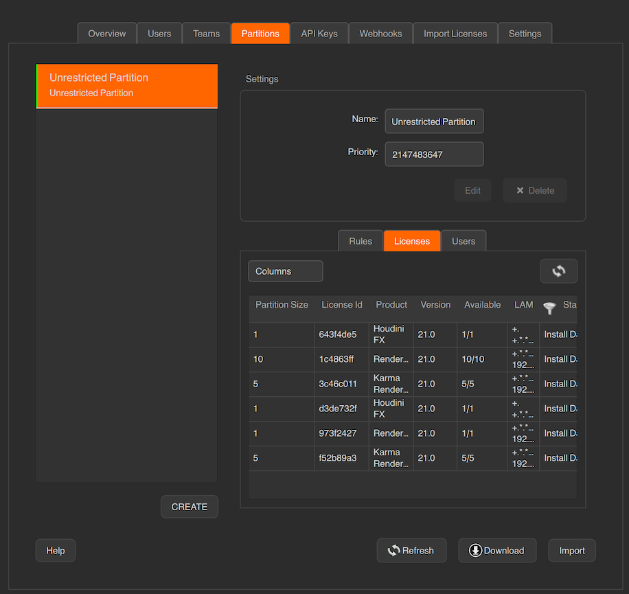

By default, all licenses are initially in the Unrestricted Partition. This means that the licenses are not partitioned and all users have access to them.
  1. Create Partition: Navigate to the Partitions tab and press the Create button. Name the partition.

Unrestricted Partition View
Press Create to create a partition.
Partition-Unrestricted-View

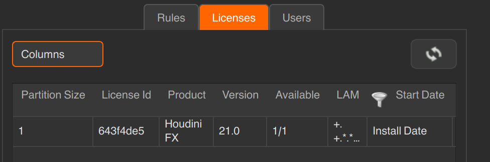

You should see the licenses that are now partitioned.
Partition Rules View
