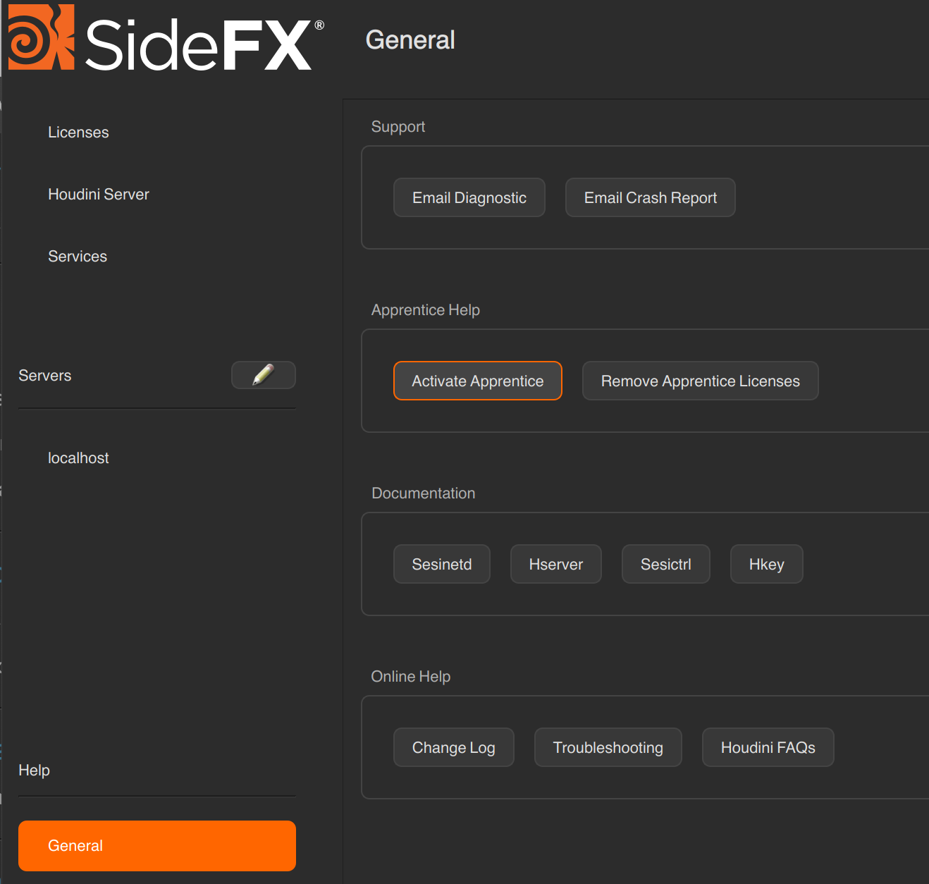

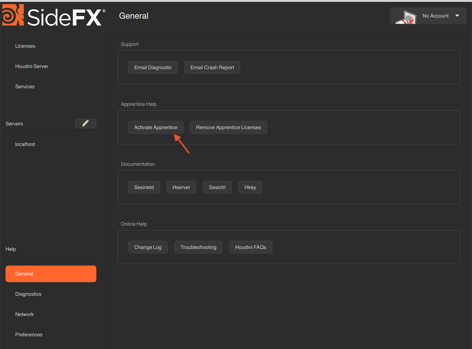

  2. Now navigate to the General menu on the left side of the License Administrator.
    Click the Activate Apprentice button.
    Activate Apprentice
