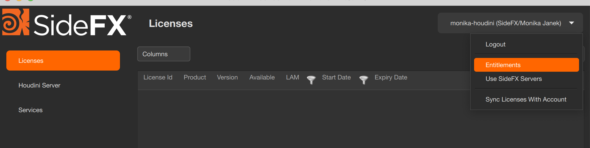

To install licenses graphically using the License Administrator (hkey):
Navigate to the top right corner of the License Administrator to select the Login menu option.
Enter your email and password credentials for your SideFX license account.
To check for entitlements to install, navigate again to the top right corner to select the Install License Entitlements menu option.
Install Licenses hkey
