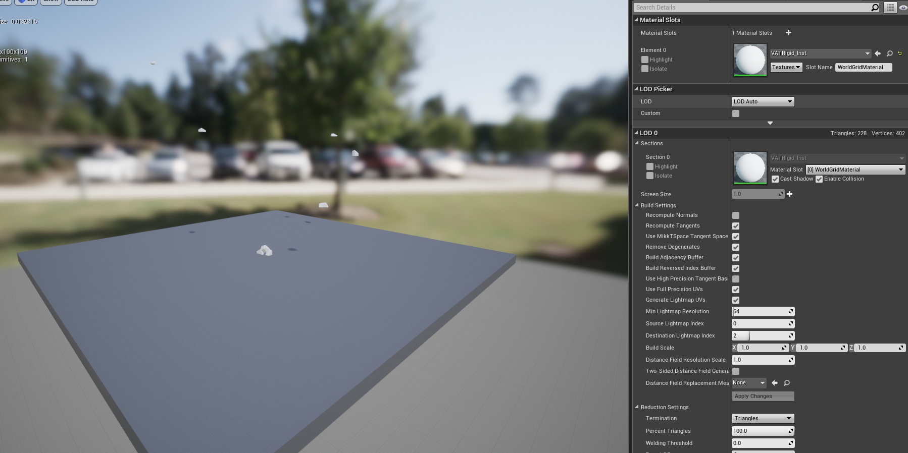

I want to output rigid's vartex animation texture and let it play with unreal engine,
The position is slightly off and does not match the preview of houdini.
It is in a state that does not fit each little.
Reading procedure
Read fbx data and rot, position map.
Each texture is vectorDisplacement
Read rigid code into material and connect each.
At this time tangent space normal is off
Create a material instace and connect each map and material.
Combine the setting of each Bounding and Number Of Frame with houdini.
Turn on Use Full Precision UVs of mesh read by FBX
Make Vertex Color Import Option Replace
Assign material to mesh
Is there anything else I need to set? What?
