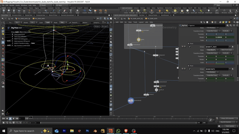

Hey folks,
Begineer here,
Have been following rig fur dude course by sidefx. On this episode "https://www.youtube.com/watch?v=tjU2ZpPbLPc&list=PLXNFA1EysfYl8k8tEcjknN66L0jqbixMB&index=14 [www.youtube.com]" at about 6:02. My left heel somehow seems to connect with right IK. I have followed exact tutorial and checked all the naming. Its showing this weird issue.
I would really appreciate your help. Thanks in advance.

hey goldfarb, did you try moving "l_heel" in "rigpose" and seen flag in "skeletonblend2". Really appreciate your help

The part where you are creating the reverse foot and mirroring it needs to be static.
