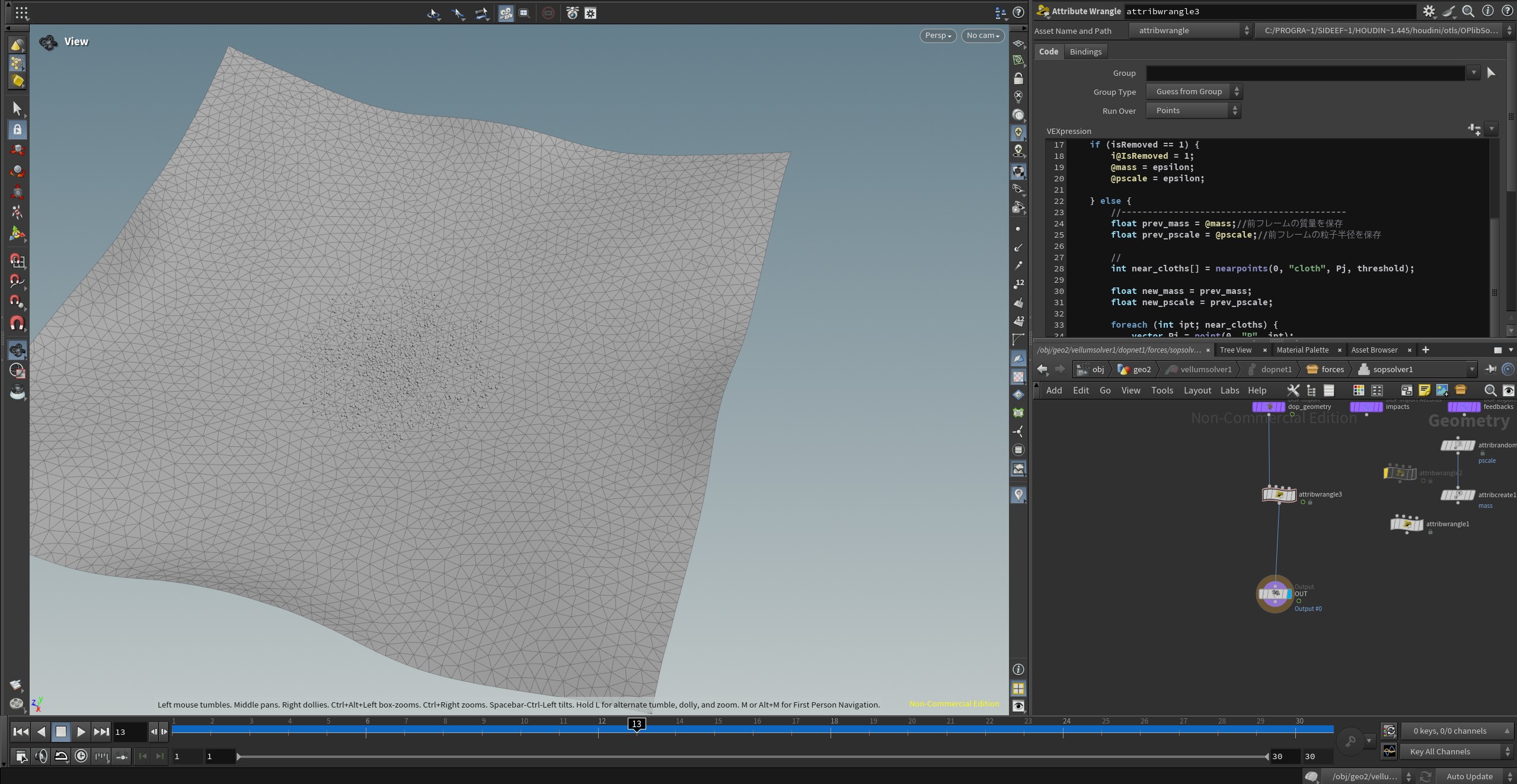

I updated the @pscale and @mass of the particles that came into contact with the cloth,
and implemented PopKill to delete particles that were completely absorbed by the cloth and had a @pscale = 0.
As shown in the image, the simulation works correctly until a certain frame, but from a certain frame, the particles fly to unexpected positions,
and the simulation suddenly collapses.
The code is written as follows in the Attribute Wrangle within Sop Solver.
If you know the cause, please let me know.
・I also tried setting epsilon=0, but it did not work.
・The threshold value is large enough.
・The "cloth" group has been changed from primitive to point for implementation purposes.
Thank you also for taking the time to make a video for me!!
It didn't work because I connected Sop Solver to Force instead of Source.
The error continues to occur, so I will ask the question again.
float particleRadius = detail(0, "ParticleRadius", 0); float threshold = particleRadius * 4; float epsilon = 0.0000000001; if (inpointgroup(0, "fluid", @ptnum)) { vector Pw = @P; int isRemoved = @IsRemoved; if (isRemoved == 1) { i@IsRemoved = 1; @mass = epsilon; @pscale = epsilon; } else { //------------------------------------------- float prev_mass = @mass; float prev_pscale = @pscale; float new_mass = prev_mass; float new_pscale = prev_pscale; int near_cloths[] = nearpoints(0, "cloth", Pw, threshold); foreach (int ipt; near_cloths) { vector Pi = point(0, "P", ipt); float max_absorption = 0.00001; float mw = new_mass; float m_min = min(max_absorption, mw); new_mass -= m_min; } if (new_mass < 0.0) { i@IsRemoved = 1; @mass = epsilon; @pscale = epsilon; } else { @mass = new_mass; new_pscale = pow((new_mass / (prev_mass + epsilon)), (1.0 / 3.0) ) * prev_pscale; if (new_pscale < 0.0) { i@IsRemoved = 1; @mass = epsilon; @pscale = epsilon; } else { @pscale = new_pscale; } } } }
