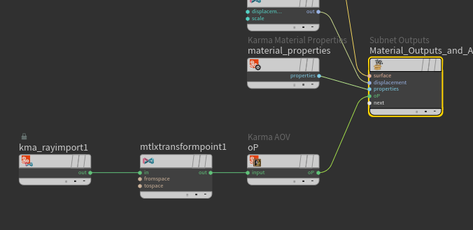

1. It looks to me like transforming from world to object space does not work as advertised. I've attached a little example scene to showcase the issue. Basically I see no visible difference between a transform world:world or world:object. And, as the object in my scene has animation on it you can clearly see that it is just swimming through the "space". There is a switch in the example scene that switches between modes, and the only one that results in no change at all (from regular world space) is the world:object So, what is wrong here? Have I done something wrong or is this a genuine bug?
2. It seems like the thing that does work predictably is to output the rest position. But, that would mean that every object in my scene would have to have a rest position to begin with, which in my case is fine, but in more complex scenes could become a bit annoying to set up, especially if you have to do it after you've sort of finished the scene already.
Would be interested in your perspectives on this.

your /box Xform contains no actual transform so it is the same as world
all your animation is done on the geometry of the box so you are animating the points which results in timesamples on points primar on /box/mesh0 which is technically a deformation
and for deforming geo you would need to use "rest"
but if your /box had animated transform with static geo inside you would see expected Object space P values
here is a modified scene with all animation being done on object level and imported through Scene Import with static box inside
you can similarly also use packed prims for this purpose if you want to animate within SOPs

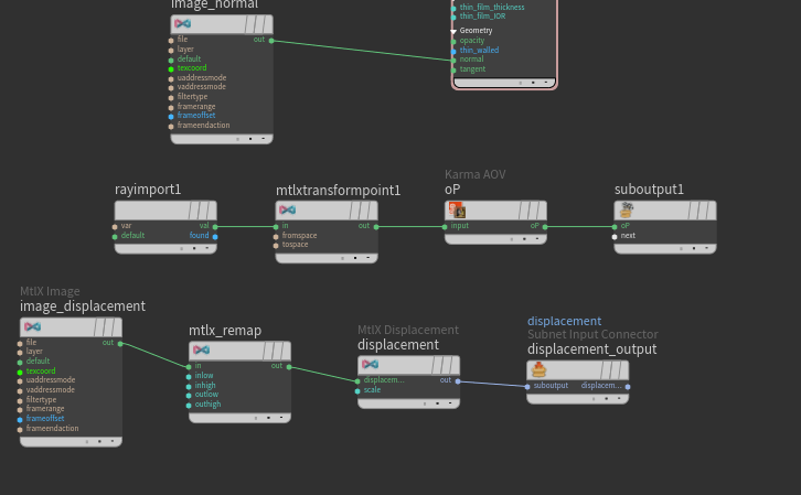

The issue I now have is that Ii can't seem to pipe the aov into materialx shaders, only karmamaterialbuilder.
The materialx material builder has different ray options and the materil itself doesn't have the AOV output on the subnet outputs.
I tried setting up the same node setup in mtlx material builder as in the karma material builder but it doesn't come out in the aov pass.
What am I missing?
I have an enomous amount of Kitbash materials that come in with the assets and it's not feasible to rebuild all the materials in karmamaterialbuilder nodes.
