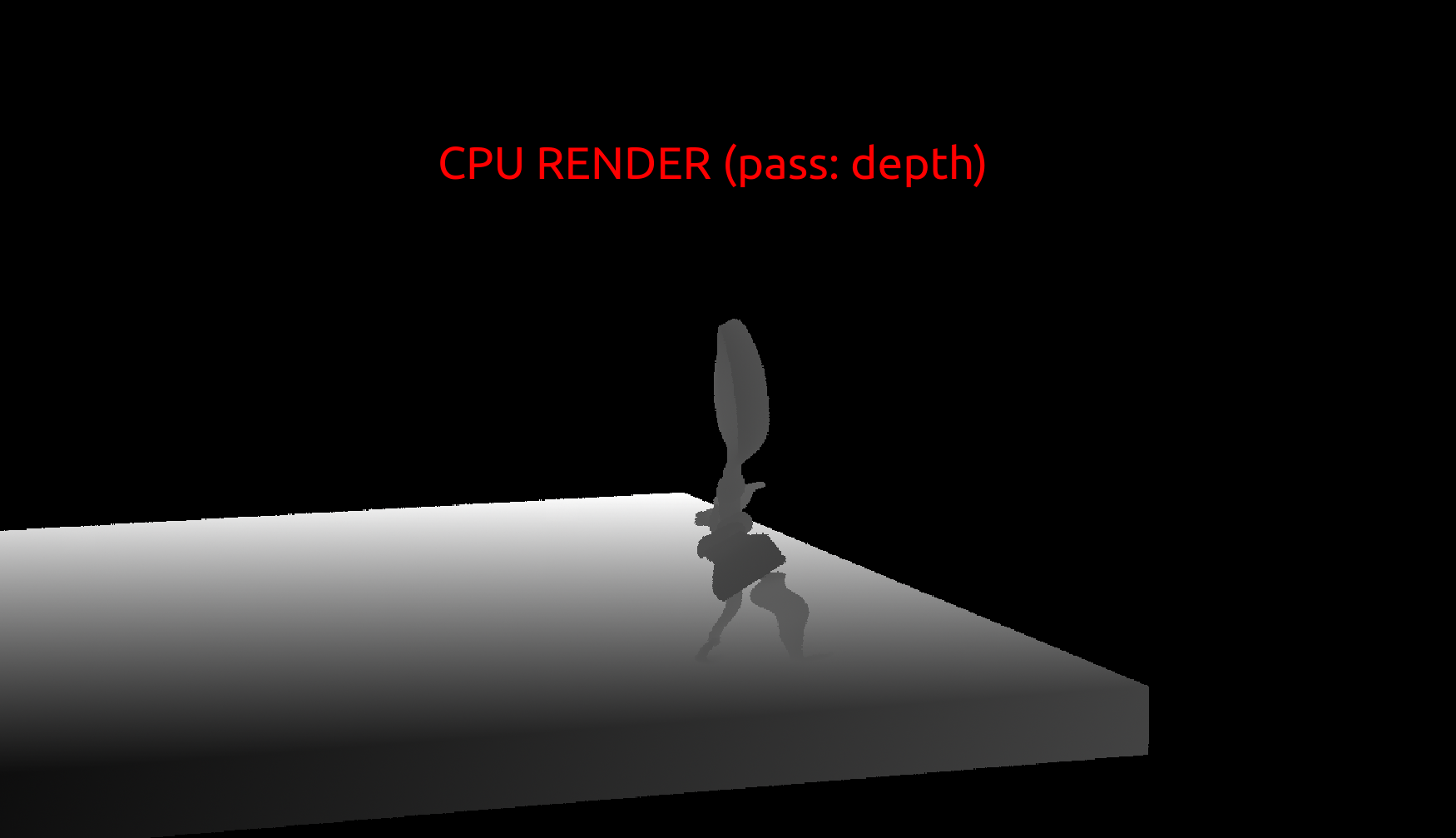

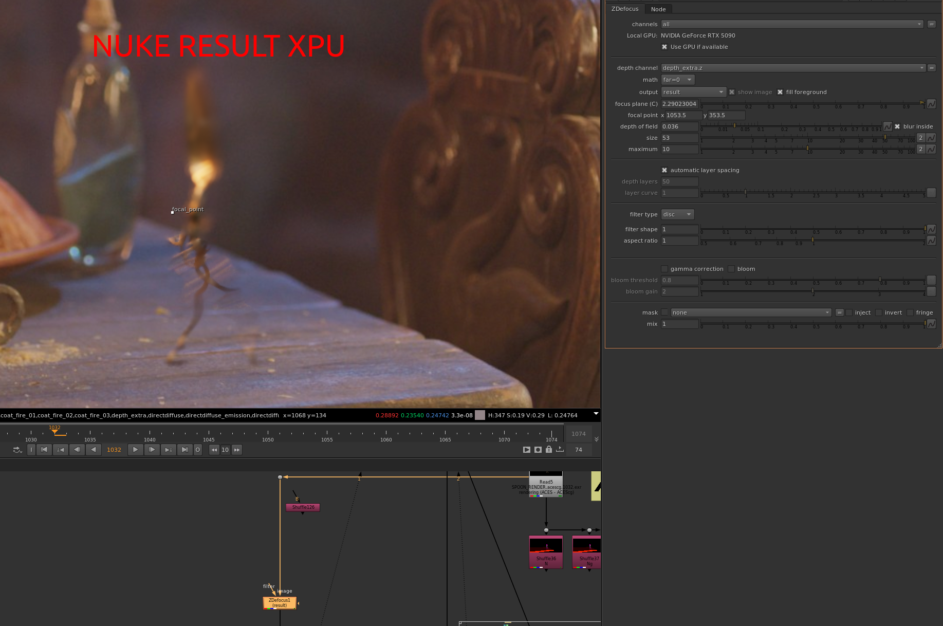

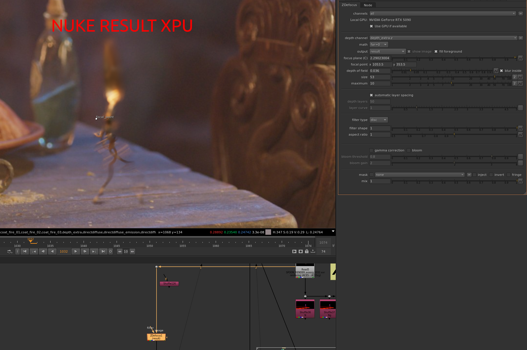

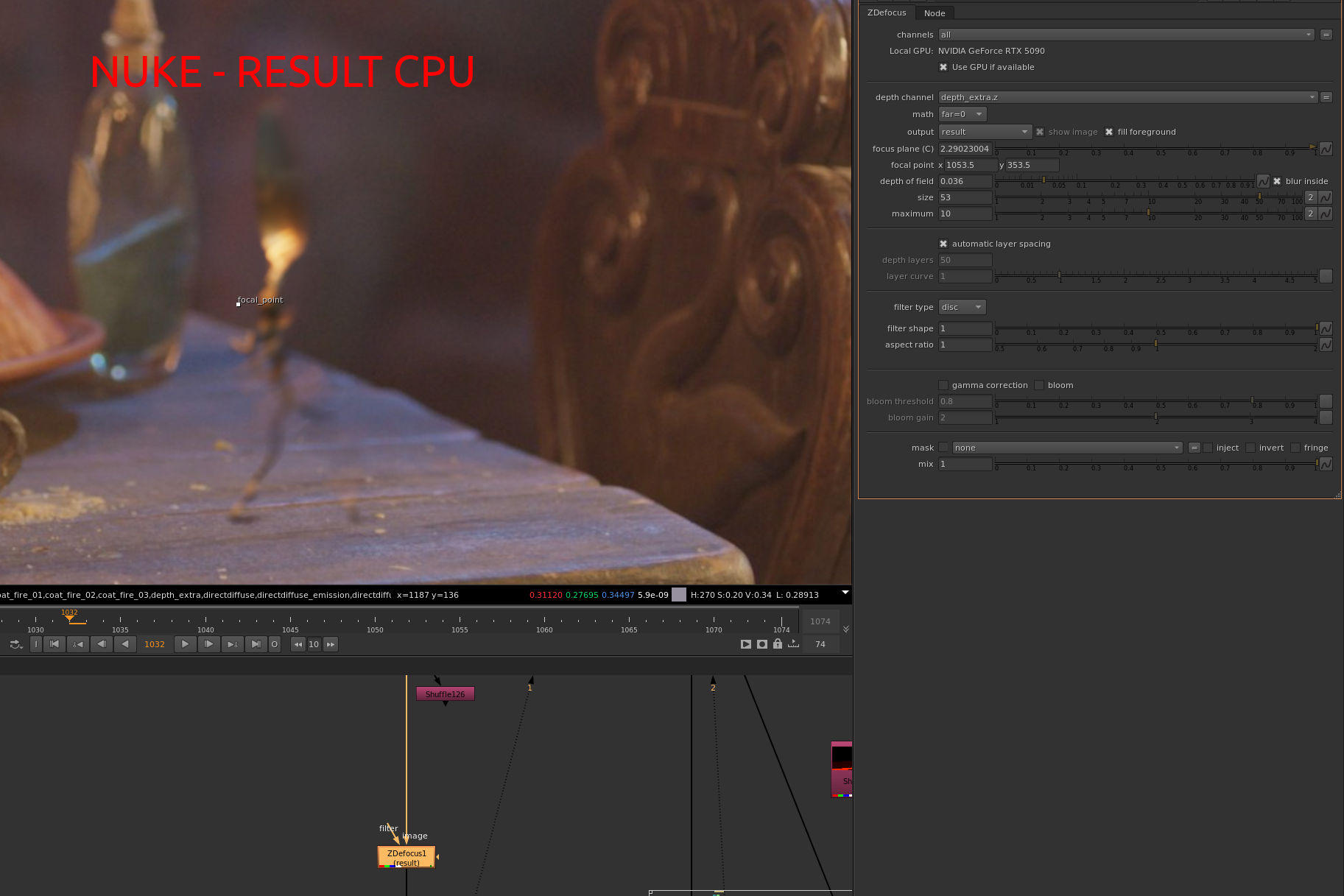

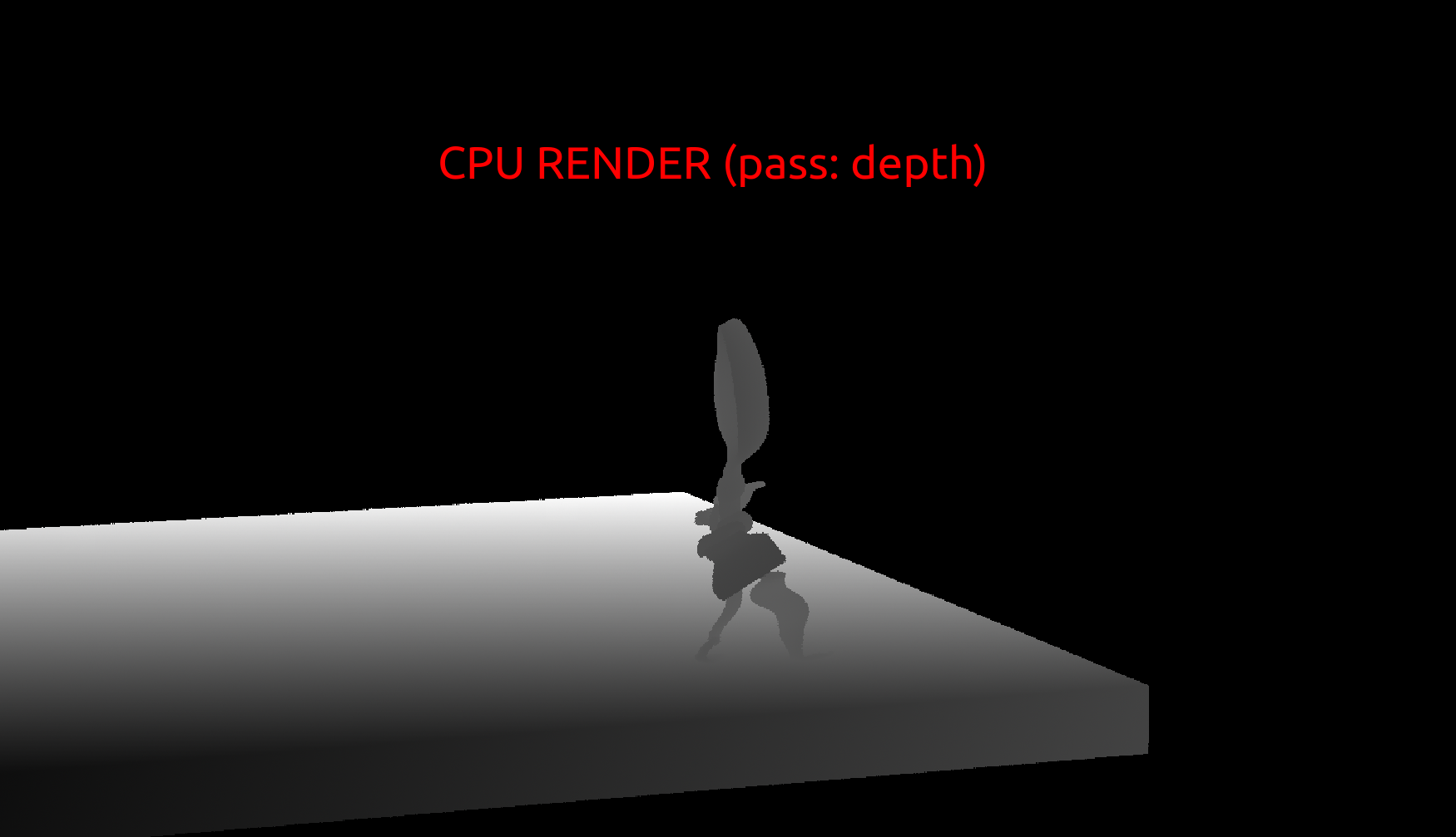

Hi, I’m running into an issue with the depth pass when rendering with Karma XPU.
On CPU, the depth pass looks solid (no transparency). When used in comp (Nuke ZDefocus), it works correctly and produces no artifacts.
On XPU, the depth pass looks very different: in areas with strong motion blur it becomes semi-transparent, which causes artifacts when applied in comp.

The "Pixel Filter = minmax zmin" is correct and is expected to give the closest sample.
Please could you file a bug with the sample scene attached and we will investigage. Thanks.
