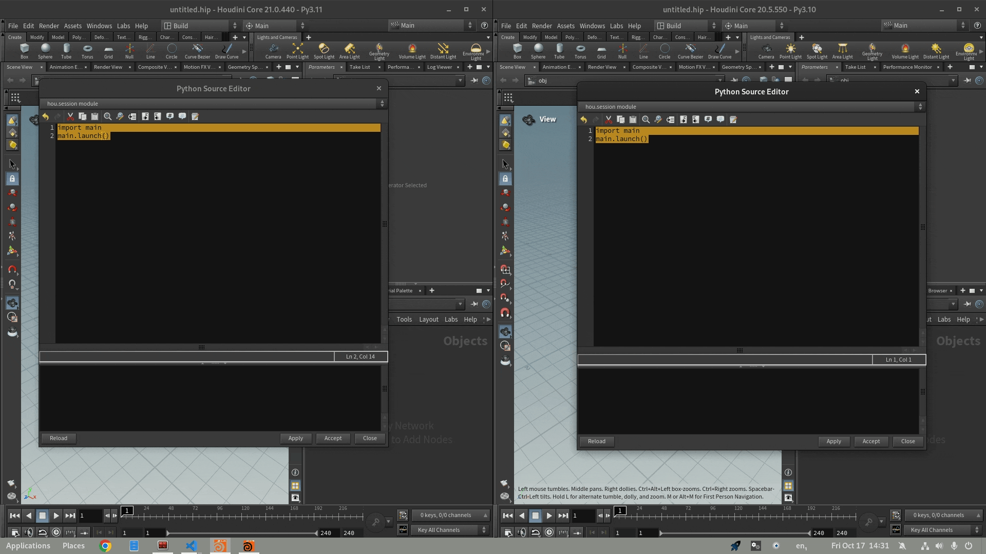

Everything seems to work great, except that the QML UIs we were using in Houdini-20.5 have some issues with Material theme in Houdini-21.
I've attached a gif showing the issue we are facing, with every hovered item having the effect shown at the top left of the window instead of on the hovered widgets.
Here is the minimal example used in the gif:

Recording 2025-10-17 at 14.34.01.gif (5.5 MB)
