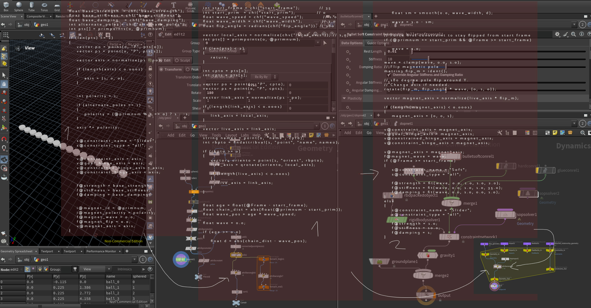

Update, using spring constraints and adjusting dynamically, but im struggling to magnet on the tip and create that connection like the reference
any thoughts?
houdini_LxHtAHVQ3h.mp4 (755.0 KB)

Try bullet-soft-constraint and slider-constraint..Investigate
