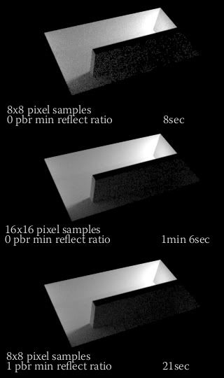

Sorry, I wrote it kinda hurried. I don't think it's a documented feature. Add these rendering parameters to mantra:
Allowable Paths (vm_pbrpathtype)
Color Limit (vm_colorlimit)
PBR Min Reflection Ratio (vm_pbrreflectratio)
Allowable Paths lets you specify caustics on top of the diffuse and specular paths. Color Limit dials down light reflection/refraction/caustics, so they are not insanely bright when rendering with PBR. Min Reflection Ratio can help anti-alias dark areas of the render, and do it more efficiently than simply cranking up pixel samples. Aside from that I noticed that it also amplifes caustics and helps anti-alias them, both of which mean you don't have to decrease the color limit quite as much. Takes a render time hit though. Valid range seems to be 0-1, even though the slider goes all the way to 10.
Hope this helps.
Hope this helps.

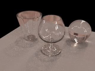

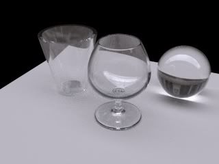

I think that's the sort of scene that's going to be difficult to use with the raytrace caustics. Ideally you'll have large light sources and lots of light bouncing around. It worked very well with the cornell box I made for example.
Here's a couple of renders with HDR maps. The first map has a lot of small intense light sources, and the caustics throw a ton of noise into the scene that's very difficult to anti-alias away. The second map has the sky as the main lightsource and noise isn't too severe.
Sorry I only included the first HDR map with the file, other one was too big. There was a pack of Houdini-ready HDR maps in .rat format on the odforce wiki, but I can't find it at the moment. :?
