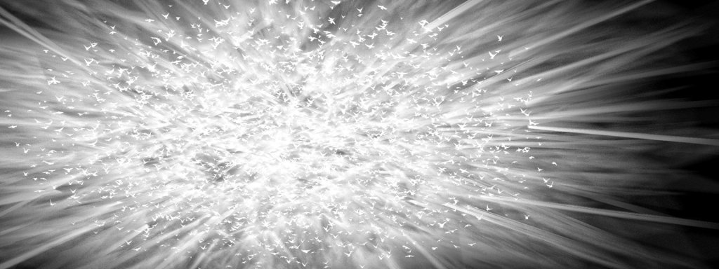

The thing is that if the motion blur is calculated on all the geometry after the Copy SOP, and the topology changes, a given point number may travel a great distance to a completely other copy instance, thus resulting in extreme motion blur (I'll post a pic of a quite cool example). But when calculating the motion blur per instance with it's own set of point numbers it's not as sensitive and will not travel such a long way upon topology change.
