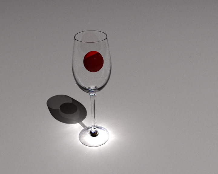

I tested on same render setting by referring to anamous file, but not sure why i got lots of white dots shadow part. I found that if the area light's scale size was too small will causes white pixels in shadows shown in picture 01. Same setting, the image outcome in animus's file is clear and nice, but in my file is very low quality and white pixels in shadows.

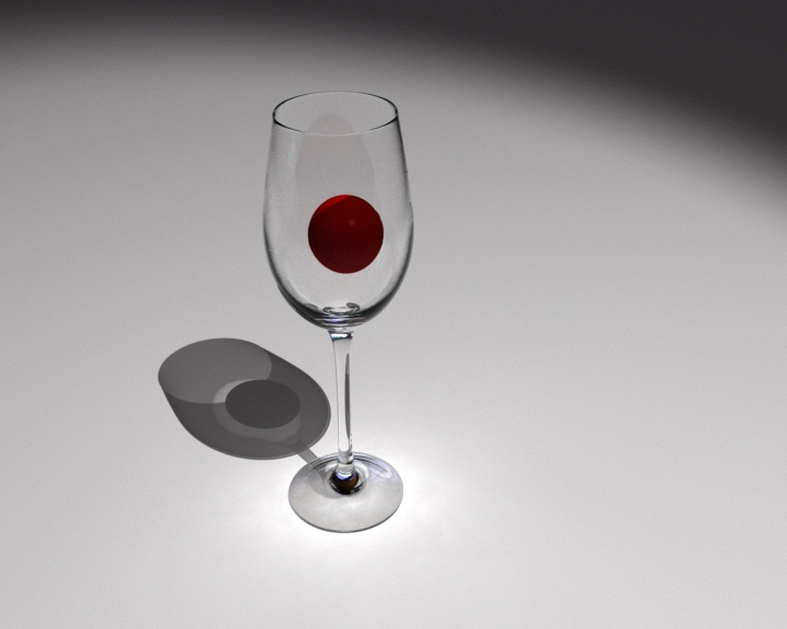

Previously, I found it had been mention in another topic “Network Render of Caustics”, that by increasing the scale size of area light for photon cache will solve the white pixel problem. So, I re-render it again, as in picture 02, there is lot of noise and no matter how many pixel sample I increase, it just won't help much but expensive render time.
So, I began to wander and figured it out by mix matching anamous's setting with some concept of my own (not sure is it right or not), and got the effect on picture 03. But the sport lights have causing the cast sharp. Here by I attached the file, please help check, I'm not sure weather I had set wrong.
