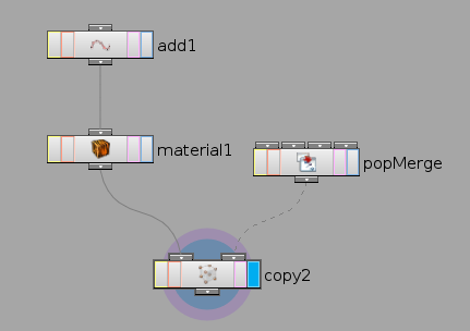

I got a bit further with figuring out how the render time instancing could work.
(see attached pic's)
But now I am getting a weird effect where the render will stop after just a few ‘tiles’ have rendered in the center of the image. (see pic)
It suggests to me a bounding box thing but my delayed load procedural is set to ‘No Bounding Box Required’.
Does anyone recognize this problem?
I just noticed that this problem disappears as I switch render mode to ‘ray trace’. So it must be some ‘Micropolygon Rendering’ setting that is not right.
cheers
fred
