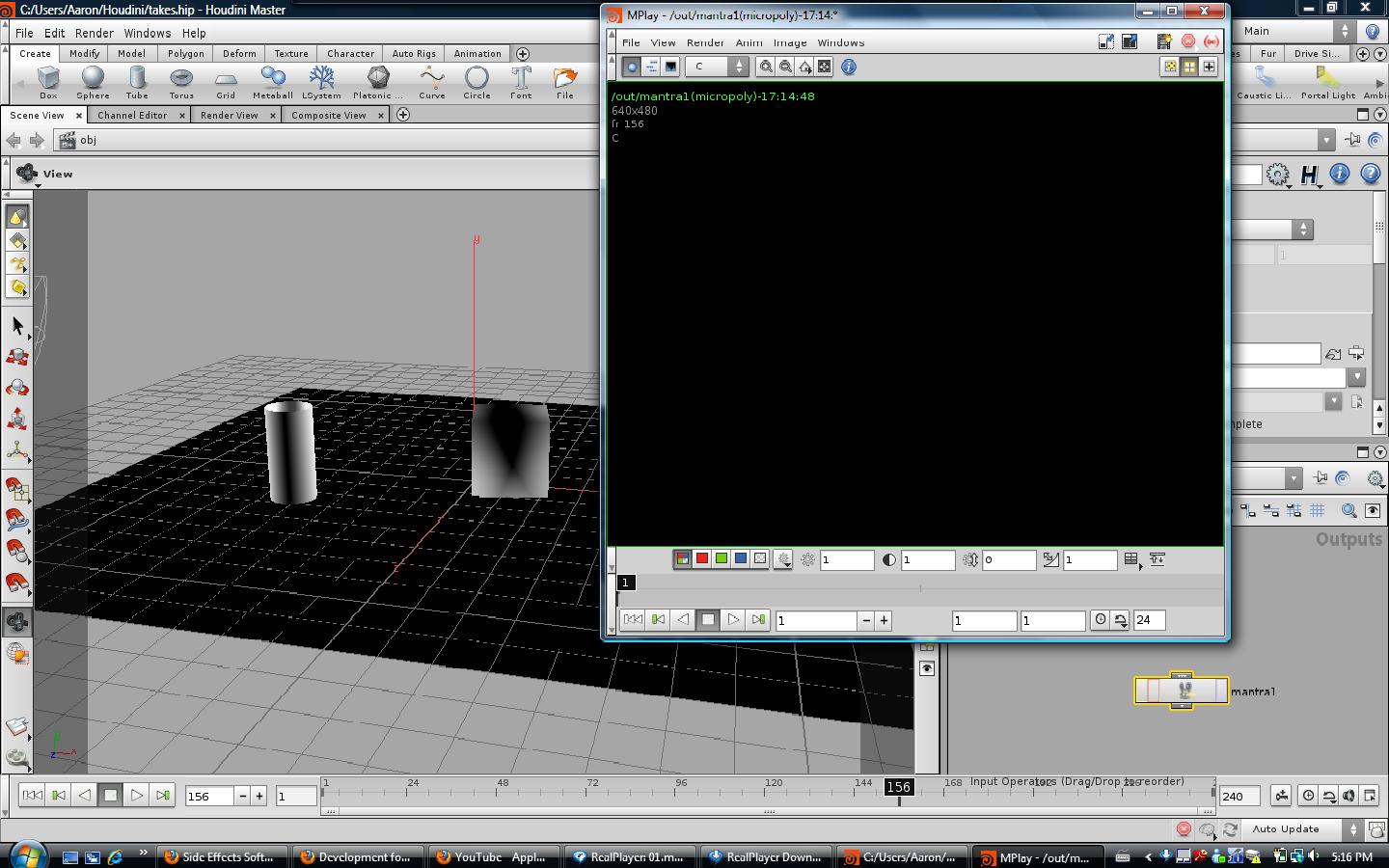

Thank you. Unfortunately that was the first thing I tried when you said to append a Point SOP but for some reason the option for Point SOP doesn't come up when i look at the list.
I've posted the file. I was working on one of the tutorials on the website. With the lights I can actually see the objects although the lights behave oddly but when i render it it is still just a black picture.

I was able to render a scene to mplay by hitting the render button in the viewport's left hand menu at the very bottom. The icon with the film can icon. Hit that and choose mantra to render. Mplay should pop up and you should see a rendered image.
I highly recommend adding a Mantra ROP Output Driver for any scene and use that to control Mantra rendering.
From the main menu at the top, go to Render >Creat Render Node
and either choose Mantra or Mantra PBR. Mantra PBR uses physically based rendering btw.
Now there are several ways to trigger a Mantra render.
- Easiest way is on the lower left of the viewport, there are two icons. The very bottom icon will show you all the various mantra render options. Choose the mantra1 output driver you added above.
- From the Mantra output driver found in /out directory, select the node and hit the Render button on the parameter interface.
Given that you are very new to Houdini, I highly recommend you switch to the Technical Desktop.
Main Menu: Window > Desktop > Technical
The Technical Desktop always has the Tree View on the left side which shows you the entire Houdini directory structure. Houdini is an actual file system in memory. The funky thing though is that nodes can both be an operator AND a folder container. Objects are that way and live in /obj. With the Tree View, you shouldn't get lost and can find your way around a lot faster.
With the Tree view readily available, you can easily see where you land when you use the various shelf tools. It's always easy to get back to /obj and see your scene objects after going to /out to inspect the output drivers that you will invariably create when you start getting in to takes and render passes.
Hope that helps a bit.
