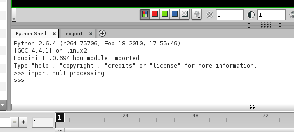

Hi Patrick,
I have tried importing the multiprocessing module successfully within H11's python shell in both Linux (Fedora 14) and OS X 10.6.6. Both OS and Houdini installations are default and nothing needs to be added to the Python lib directories.
From google searches, it seems that the multiprocessing module has problems working in Windows within an interactive Python console.
Perhaps you can try using a Mac or Linux-based PC instead if it is feasible?
Cheers,
tk
