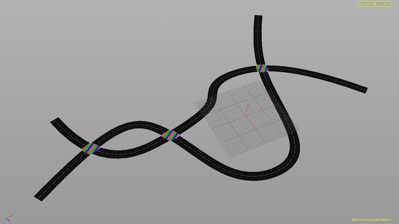

Is there a way to create clean intersection path from multiple curves?
I have tried many different things but I'm running out of ideas.
Also tried some VDB solutions but but when converting back to poly's I cant get clean geometry.. :'(
Please check the attached file and thanks in advance!

I've got a solution now.. but I'm not sure this is the best solution.
Please check my file..
Any feedback is welcome!

here is a quick test:
hope it helps
edit: another file with more controls
refining faster and smoothing of angles if desired.
version 3 with sidewalks and stuff
roadtest_metaball2.hip (132.4 KB)

I found another way for clean intersections, it also works with very complex shapes!
intersections_new.hipnc (152.6 KB)

I've also added some procedural uv's for the road, now the last thing to do is generate useable uv's for the crossings.. : 8)

I have better intersections now, now its indestructable!
Look at the file..
intersections_01.hipnc (114.6 KB)

I wonder if you would like to share your method to get propet UV. It seems it's not implement in youre last hip file.

Anyways, I had a few days off so I decided to tackle this issue once more and it is a but more rock solid now! Still not perfect, dont do funny weird stuff.. :wink:
I've also supplied some texxtures to this system.
The file is a bit messy and very complex so beware..
intersection.zip (397.0 KB)
