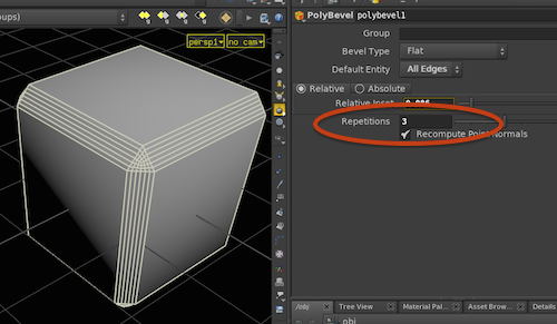

Any idea why when setting the bevel repetitions to 2 it goes to 4 rows of polys?
So ‘0’ is for one row of polys (the original one), ‘1’ is for two rows (the original split in two) and then ‘2’ creates four rows of polys instead of three.
At first I thought the algorithm is “power of two”:
'0' -> 1 row
'1' -> 2 rows
'2' -> 4 rows
but then:
'3' -> 6 rows
What gives?
Also, what if I need 3 rows?
Is this an overlook or a feature?
How about number of repetitions creates the same number of polygon rows?
So the default and minimum value would start at ‘1’, set it to ‘2’ to have two rows, to ‘3’ to have three rows of polys and so forth.
Edited by - May 5, 2014 20:28:52
4189 posts
Joined: June 2012
Not sure, 3 repetitions appears to be working. H 13.0.401, OsX
3 reps.png (107.6 KB)
1755 posts
Joined: March 2014
Working as in… not being 5 but 6?
I did miscount the number of rows for 3 reps, it's true, but replace “5” with “6” in my comment and what I've said is just as valid (or at least remains to be seen if that's the case).
Here, I've edited above and marked the edited text with red.
Of course, now I can ask what if I want 5 rows of polys? I'm not going to test with bigger numbers in the hope I'll figure out a pattern, I'll just wait for a dev. to come and clarify this.

4189 posts
Joined: June 2012
Isn't it just the Fibonacci number?
3 reps = 2+3, 5 reps = 4+5, 8 = 7+8 etc
edit: perhaps the label should be ‘rabbits’ not ‘repetitions’
