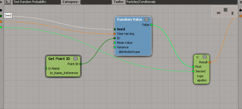

My impression so far is that the capability is there but in a very low level way that means certain tasks you have to build every single time, for this reason softimage wrapped certain low level nodes onto bigger compounds to make people's life easier.
A good example is “Test random probability” compound that contains this inside… Notice the functions from Mean Value and Variance…
The same for “Get closes location” which is not trivial to build in Houdini.
I would love to discuss this further and see if there is real value on such an effort.

“Get closest location” is currently implemented as Minimum Position VOP (new in H12.5 or 13). “Test random probability” might be good candidate though (Compare VOP between Random VOP and trigger value plugged into a Two Way Switch VOP, so one instead of three nodes…).
Generally speaking making ICE nodes for VOPs might be unrealistic. Perhaps better approach would be a database of common idioms? So an atomic operations in ICE with corresponding VOPs counterparts would be listed in alphabetical order.
I feel like ICE is too different from VOPs to make straight ports possible in any but the easiest cases.
