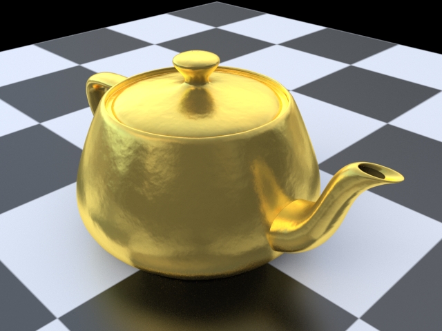

Crank up the ior to like 9….I just made a nice gold shader that was extensively used. I used a ramp driven Fresnel and an egdeFalloff connected to a ramp piped into spec and diffuse. A little noise on the normals….
258 posts
Joined:
I do not have that shader as it was done onsite but here is a quick mock up…
gold.hip (550.6 KB)

interesting approach . Another version of some gold
