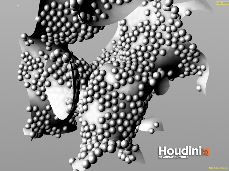

Hi all,
I'm trying to attach many FEM (or RBD initally for testing purposes) to an arbitrary surface, but I'm not sure how to go about this, but I have a general idea to try and create a vector field that points towards a surface.
Take a look at the attached image and imagine some field lines following those normals.

What you want is a gradient of an sdf volume. Let's leave the implementation as an excercise for now

607 posts
Joined: May 2007
I'd recommend ditching the point cloud and use volumes. Here is a solution where I make an sdf of the geometry and take its gradient, and use that as a field force in DOPs. (Actually what I meant in my first post)
Edited by - April 13, 2014 07:38:25
attract_to_surface_cells_ee.hipnc (408.2 KB)

271 posts
Joined: March 2012
That worked a lot better than what I had previously.
Do you have any ideas about how to get the spheres to grow while being simulated with finite elements? (or cloth if that's easier, just something that makes them look organic and squishy)
