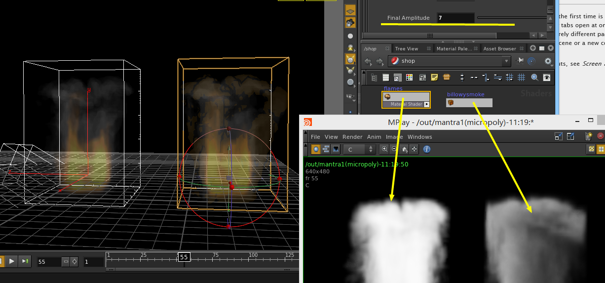

4189 posts
Joined: June 2012
Not sure what your setting are, always try to share a .hip file.
Attached is the same flame, one with a flames shader and the other with a billowy smoke.
Does that do the ‘self-shadow’ you are talking about? Appears that you are after more shading than shadowing.
smokey.hip (1.5 MB)

680 posts
Joined: Nov. 2013
It worked! I'v set parameters as your mention, but I set shadow color to Black, so no self shadow. When set to White the self shadow worked! Thanks!
