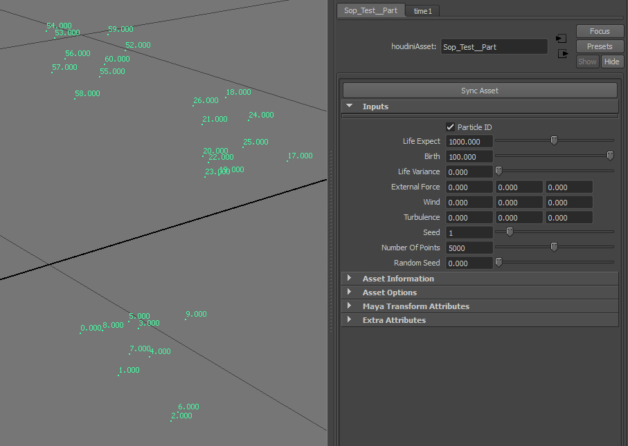

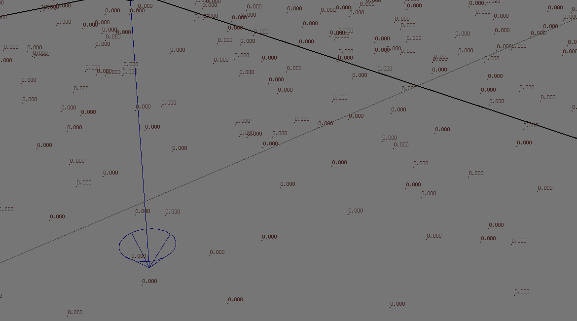

How can i give a number\name to the particles that i import in maya?
In houdini i have a number per particle, when i load it to maya the number that i have in all the particles, is 0.00
Is it posible to give a number to the particles imported from the engine?

This is probably an update issue with nParticle. After you added the per-particle attribute onto the nParticle node, you probably need to change a frame in order for the nParticle to pickup the new values coming in from the asset. So try just changing a frame, and you should see the values from the Houdini attribute.
Note that you can only have float or vector per-particle attributes on nParticle, so you can't output string attributes. Int per-particle attribute doesn't work right now, but the Maya plugin could make it work by converting it into a float per-particle attribute.

Thanks for the help Awong, found my problem, it was a noob solution, i didnt add the particle ID to the digital asset. If the ID particle isnt added on the digital asset, maya don't know what particle is and put it all in 0.
