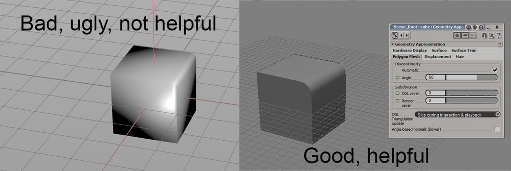

Is there a way to set a smoothing angle globally for the viewport?
I mean, so, that if I create a box it will show facetted an a sphere will show smoothed just like the facet sop, but globally, only for the viewport?
The facet tool is great for the finished model but completely awful for working.
Viewport Normals (aka Autosmoothing)

I know he isn't talking about the smooth shading. He is talking about the bevel which is set to FLAT (two sharp egdes instead of one) but he says the result was slightly rounded. This is an error because you cant actually see what is rounded and what is not whith the 80's style gouraud shading. Is the closest top corner of the left box in the screenshot rounded or not?

I know you can use a facet op etc. in fact you have to, and you have to keep it at the end of the network. Wouldn't you agree, that it would make things a lot easier, if you had a basic viewport anglebased setting, which you can override with a facet sop when youre done modelling? That is what my original question is about.

I would ask for that too, but I'd rather ask to get rid of that gouraud shading technique first. You really only find that in houdini, and I think noone would say this is superior to the methods found in (all) other tools. If you import a CAD model without usernormals in houdini for the first time its quite a shock. I mean you have OGL 3.3, highend workstation graphicscard (still) required, IBL, AO and softshadows for the viewport, but you have to add an sop to get your geometry displayed correctly while it is likely to dynamically change quite a bit while editing. Even the blender guys have build in this functionality this year.
And what about an option to use viewport normal for rendering, or an object level setting that overrides the global even while the geo changes and can still be overridden by a sop? Wouldn't that be better than trying to figure out if the sides of the cube are planar or not as long as there is no operator that exactly does what could be done globally and becomes invalid as soon as you start modeling? I am only asking for an improvement that is well established already everywhere else. No one would suffer from it. There could even be an option to turn it off

Something I have learned during the last 20 years is that mathematical or physical correctness is not a guarantee for usefulness. I really like houdini - it is logical, intelligent (most important) and very elegant in most parts. The viewportshading is the one feature that really stands out. Even if it is mathematically correct, it does nothing to aid or support the user.
If I'm to model something I need to be able to judge the surface. I need to know where creases are and if the belong there. I need to know if a quad is planar or if that black corner is black because of a colored vertex or because of a material or the viewport shading. And I actually don't care what the tech is called as long as it is useful to me
