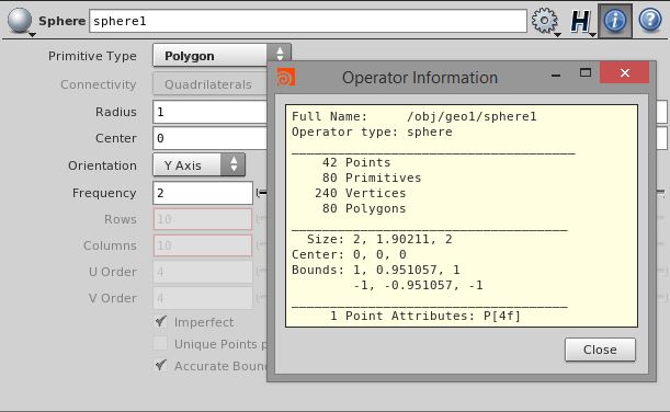

I see these two ways to show or find out about the polycount of the selected node in your graph.
1. MMB on the icon of the node, gives you a little note pop-up with all useful informations
2. select the node and in the parameters tab click “the white i in the blue dot” - see attached image (Operator Information)
Hope that helps :wink:
Greetings
Allan
Greetings
Allan

Thank you very kindly for your help! However I have over 50 objects as i try to use houdini for modeling (including GAME scene modeling). I assume there is no direct way to get a complete overview of all objects ( poly count? ). I think i could iterate through nodes with python and try fetch that data, just wanted to know if there is a direct way?
