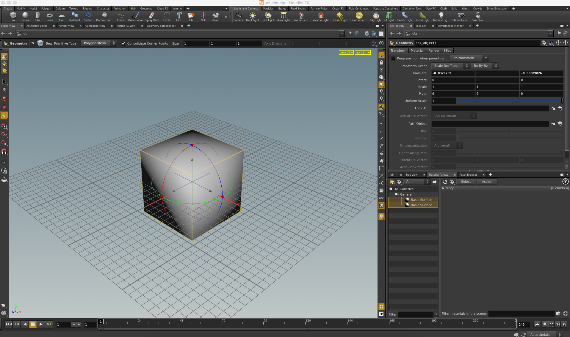

I am new to Houdini, so I'm not sure it's a bug… But my materials palette is empty right now, and I don't know what to do
There's only Basic Surface (the twin in the screenshot is due to the fact that I tried to reload the Materials.gal). I'm on mac, using the latest dailt build (258).

Yes, the Material Palette should be full of materials. Not sure but try deleting or renaming the preference folder in ~/Library/Preference/houdini/14.0, or, reinstalling Houdini.
Joined: Feb. 2015
Thank you so much ! Deleting the preferences worked, don't know what I've changed to make everything disappear but nevermind…
