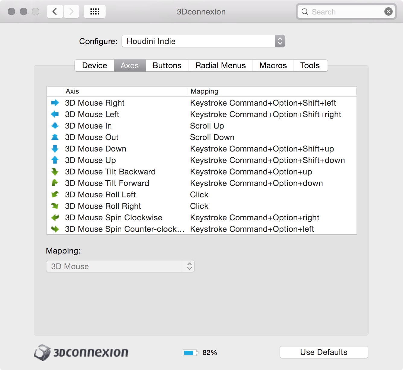

I've reconfigured the 3Dconnexion driver settings to use my wireless SpaceMouse with Houdini. It requires a lot of trial to adjust the sensitivity to the environment but works (but doesn't feel native) as long as the mouse cursor is in the 3D view.
