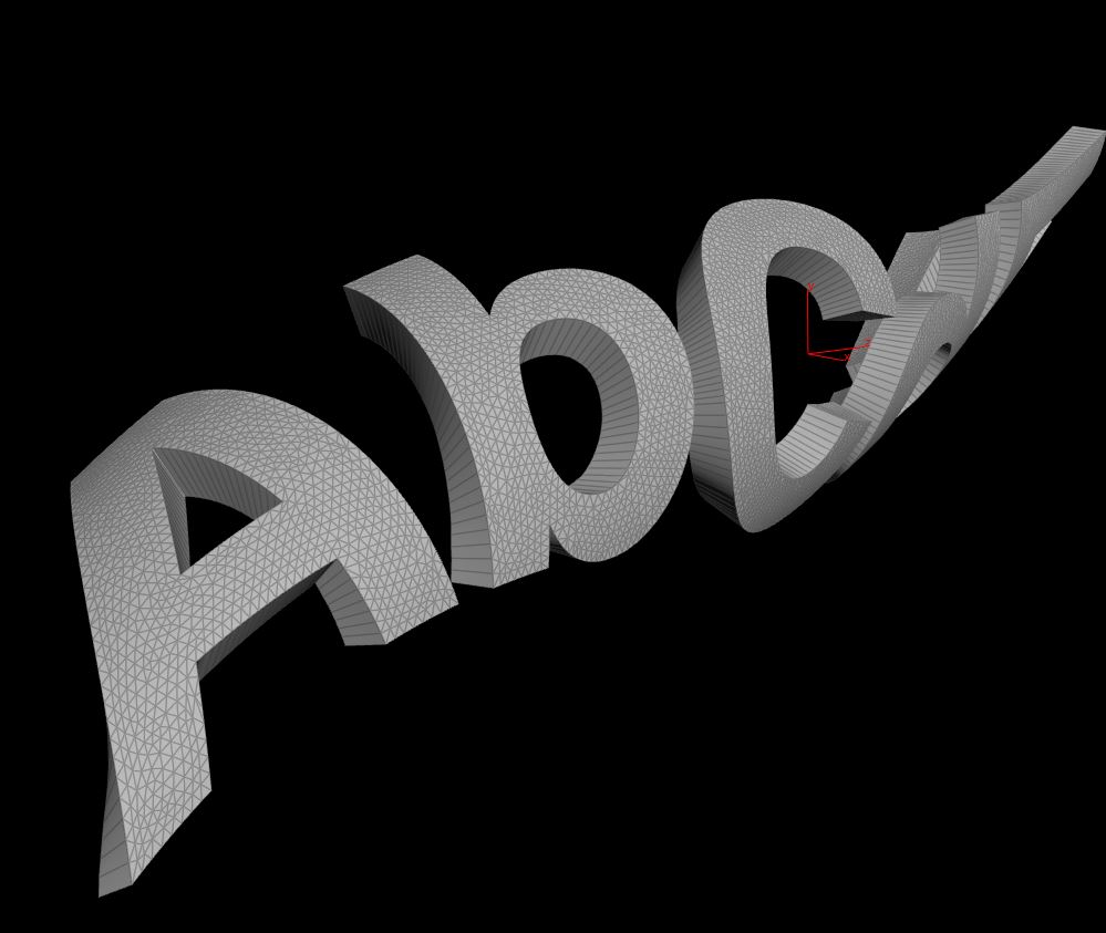

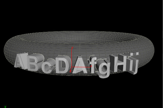

hi, a very beginner level question…
i am trying to create a logo with text shaped like being projected onto a torus.
1. used ray sop to project a grid onto a torus
2. used lattice to shape font with grid onto torus
However as i extrude the font then, i get weird results like these.
Kindly anyone suggest where am i going wrong.

I think your main problem is, that you want to deform the surface of the letters, but the Lattice SOP just deforms points. In your case it deforms your curve CVs. There is no real bending happening on the surface. That's why your “A” still has straight edges.
There are two things you could do:
You could try to remesh / divide ( bricker ) your letters until you have enough detail, then do the bending and extrusion and whatnot.
You could also project the letters onto a nurbs torus with the Project SOP + Trim or Profile, but then you're in nurbs-land and that is a bigger chapter in itself ( with a bit of headache )

Looking closely at the primitives that form the front faces of the fonts, they are each a single curve/face. It's what you get when you extrude fonts. Deforming a single concave/convex complex curve face is not going to render kindly either in the viewport or Mantra.
You can use the Divide SOP to cut up your geometry. There is an option in the Divide SOP that allows you to “bricker” or cut up your geometry so that these large complex faces can be cut up in to quads/tri's so that they render/display better.
Just insert a Divide SOP, turn off Convex Polygons (if you want), then enable the Bricker Polygons option. Use your MMB on the size parameter label to adjust the cut dimensions to get polygons of a reasonable size to support proper deformation of the faces.
See the attached example file. Just flip the switch SOP to see the difference brickering the font makes.

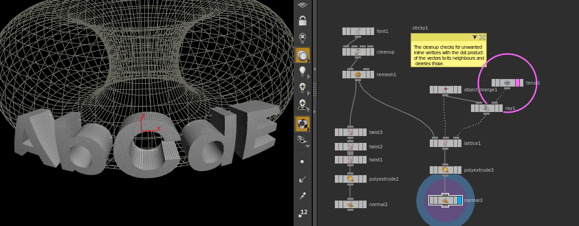

… thanks… they say it right: Help will always be given at this forum to those who ask for it.
1. Jeff, I tried to append divide sop but doesn't seem to work well with raysop. Getting good results with twist… but not with raysop. Yeah, being at a beginners stage, i might be going wrong somewhere.
2. As suggested by blackpixel, I tried his clean up node with my raysop network and everything works fine… looking great in viewport as well as renders out well. Whether I append polyextrude later or even when its used before raysop.
I am trying to understand in bits what you did at cleanup (attributeVOP), still if you can elaborate it, shall be of good help for beginners like me. thanks

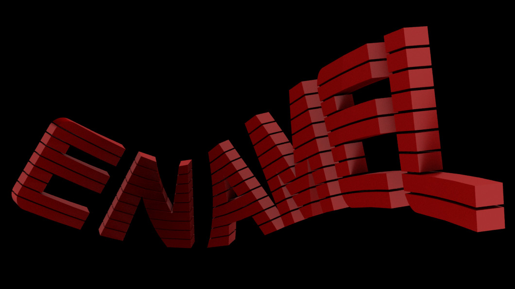

@neeraj: I am trying the setup you have posted in the image but I don't know what to connect to the Object Merge. What object did you merge in to make your system work?
@Aizatulin: Your system is a nice alternative but it distorts the proportions of the font or logo. Is there any way to use your creep setup and not distort the proportions? I realize the bend is a distortion, but the font/logo needs to keep its original volume based shape in the process.

Here is a hybrid example file. I took blackpixel's font fixup nodes and put them in Symbolic's path deform vopsop example (found at the first link I posted).
This gives a pretty good deform along a path with easy animation controls. But extreme bends in a path do cause some render anomalies. Notice the edge of the letter “C”.

It shouldn't really matter if you use the Divide SOP or the Remesh SOP . The latter can also be quite demanding with increased complexity. As jeff said, you just need to cut it up more to support your deformations.
@Neeraj:
The Divide SOP in divide_withRaysop.jpg doesn't work because your bricker size has negative values :wink:
About the cleanup Attribute VOP:
It is just a way to get rid of points, that are lined up on straight lines or spiky artifacts.
Say you have the connected points A—–B—–C and you want to know if point B can be deleted. What you do is get the normalized vectors to B's neighbors ( BA and BC ) and calculate the dot product. This gives you a scalar value between -1 and 1. You could use arccosine and “radians to degrees” to get the actual angle, but that's not needed in this case -> -1 = 180° and 1 = 0° -> points that are close to those values are either on a straight line or form a sharp spike -> delete. You do that for every point that has exactly 2 neighbors.
Here's a great lecture about vectors and the dot product in particular:
https://www.youtube.com/watch?v=PxCxlsl_YwY [youtube.com]
@Neeraj:

wow… grt help. thanks all. Helped me a lot understanding newer nodes and techniques.
hi Enivob: i brought grid onto object Merge
jeff and blackpixel: yes yes… i messed up with bricker size. Also trying to come up with what you explained what you did in cleanup attribute vop. thanks
Also the alternative provided by aizatulin is working grt.
