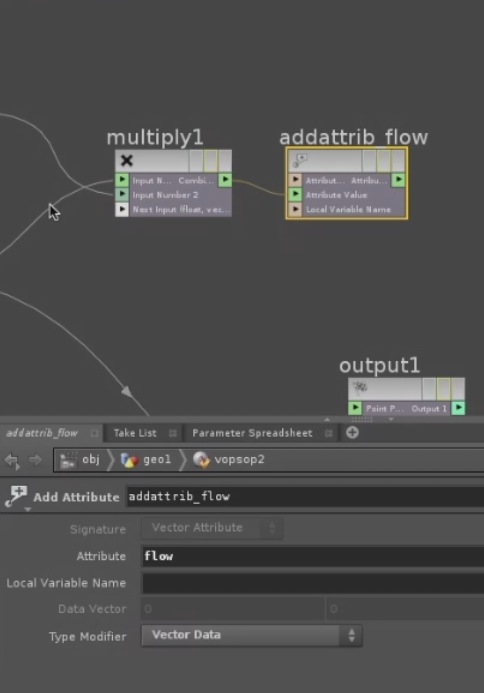

Hi guys, in Houdini 12 into the VOP node, adding the “Add Attribute” Node was possibile modify the type (see screenshot).

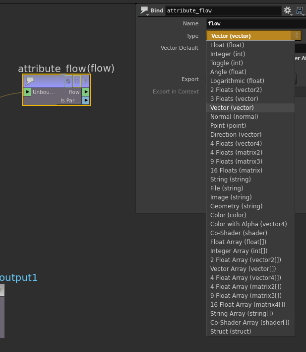

In Houdini 14 I used the Bind Export to create an attribute but I nedd to modify it as the 12, switching from “Normal Data” to “Vector Data”.
How can I do?
I attach some screen to show the Houdini 12 situation and the Houdini 14.

Ok guys maybe I found a walkaround and I want share it with you.
To obtein the same results of the houdini 12 I used a Bind to export the attribute and an Add Attribute to define the Type. So now it's working.
I don't know if this is the right way to do but actually it's going.
I'm happy to share with you and every suggestion is more than welcome!
Thank You!
