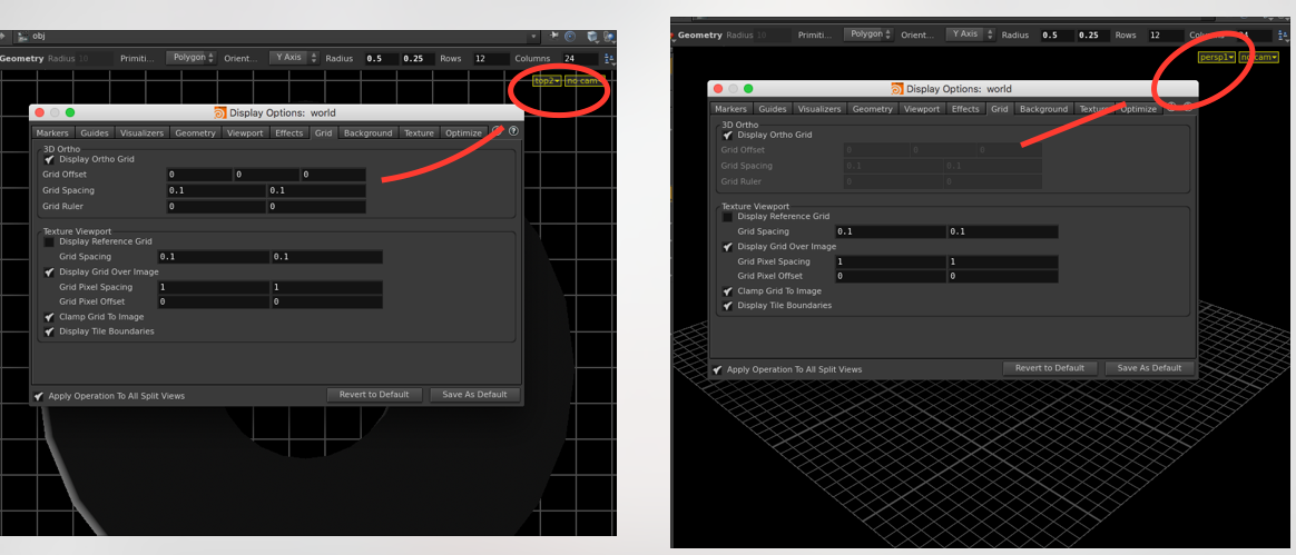

Here it is: When you right click on the little symbol that turns off the constr.plane and the ortho grid it behaves exactly as expected. It turn off the grid. However if you then open the display options and go to the grid tap you may find that the ortho grid parameter are greyed out. This is even saved with the scene.
Now there may be an explanation for it but it is not a) obvious, b) anywhere documented.
Things like that make me want to close houdini and say “why bother? I have software I am familiar with” because instead of trying something I would like to do in houdini I am forced to figure out what happens here or write a post or report a bug.

It took ME less than 6 minutes to find the next issue (though it took half an hour to find out what is wrong). I am talking about issues here because I'm never sure if it is a bug unless someone can tell me it's not a feature. It is an issue because it hinders me in my workflow. And it confuses newcomers and generally slows things down.

The ‘Display Ortho Grid’ - hover your mouse over it and it says it's for the Ortho Viewports. Press ‘N’ key over a orthographic viewport to select it and then the grid options appear.
The one in the Perspective is called the Construction Plane, so you use the Construction Plane Parameters from the ‘Persp1’ menu to edit the values there.
That is not the issue. I know how to adjust grid and construction plane. The issue is that it is possible to “freeze” the input controls for the orthogrid. You have looked at my screenshot haven't you?

Your screenshot is has greyed out ,'freezed', as you have a perspective viewport selected, when you switch to an orthographic viewport they will become active. Check the attached screenshots.
