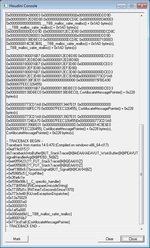

I managed to get some console feedback. What is odd is I see mention of VRAY in the text. I don't even have VRAY and Apprentice would not run it anyway.
This message appears in the console after I see all 8 buckets appear in the viewport.
Blender is clearly using all 8 threads when rendering without a problem also Handbrake can encode video using all 8 threads so I am not ready to say the CPU is bad yet. It was purchased new and sealed. I have built many computers over the years so I feel like I did the install correctly with the thermal paste and fan.
Maybe the CPU needs to burn in or something funky like that..?

I did have a copy of H14.470 installed and tried that as well. Mantra does not crash, however, it does not render either. The console has a more tidy message with the TRACEBACK BEGIN/END.
Here is what is in the crash log.
Crash report from Admin; Houdini FX Version 15.0.277
Uptime 60 seconds
Thu Nov 05 14:34:11 2015
Caught signal 4
Traceback from 4900 ThreadId=0x00000758
+0x0fd30037
