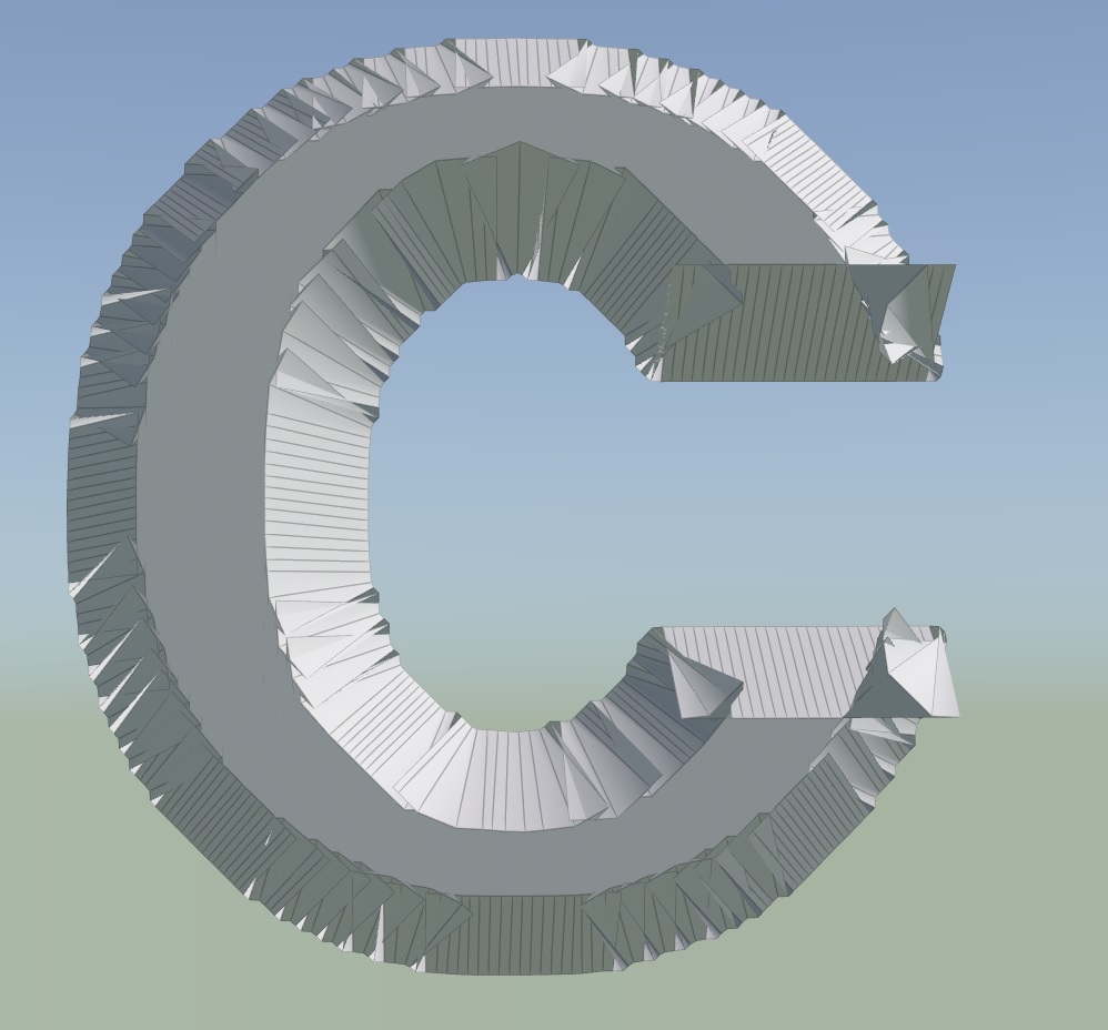

I'm wondering if anyone has figured out how to solve this problem with the extrude sop?

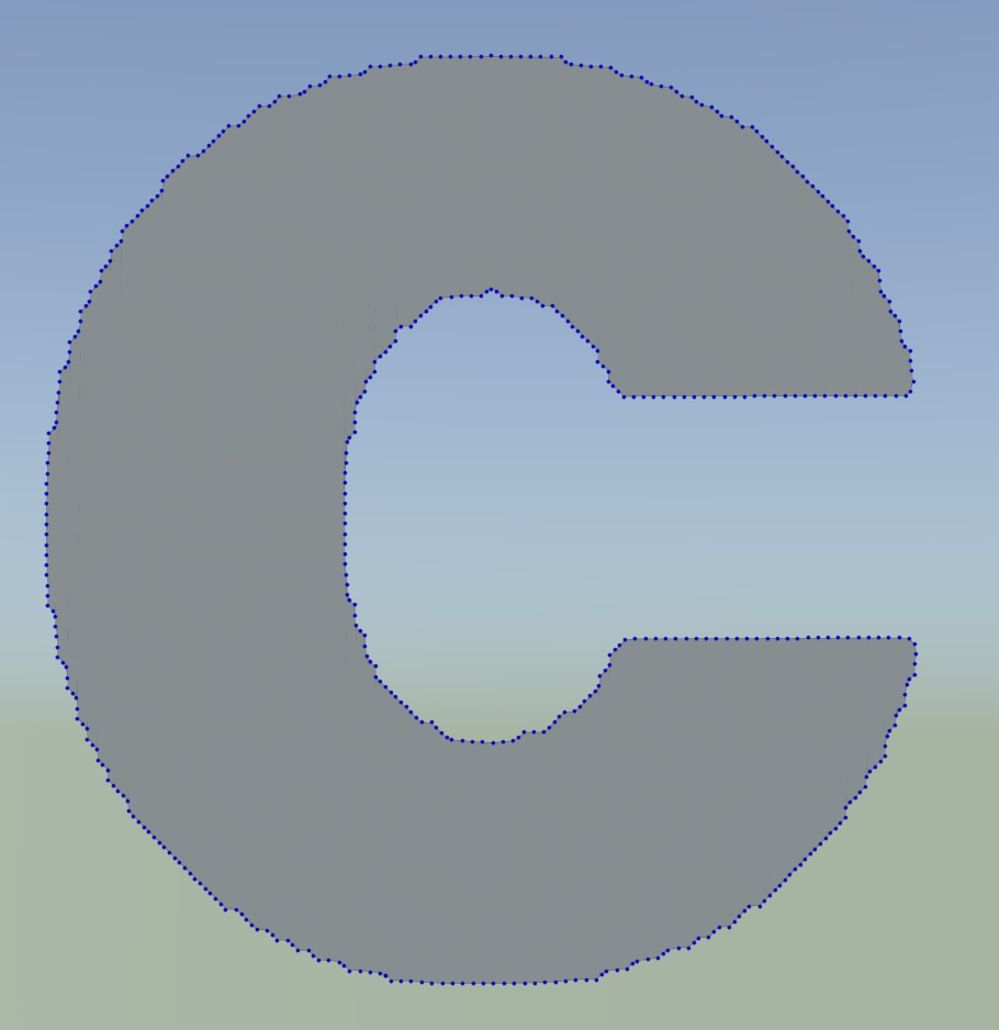

I have a trace of the letter C, and I would like to add an inset with the extrusion. However the result has overlapping polygons. Is there a way to correct this? I thought it might be to do with the normals but they're all in the same direction…
What I'm trying to get is the extrusion meeting in the middle of the letter….
