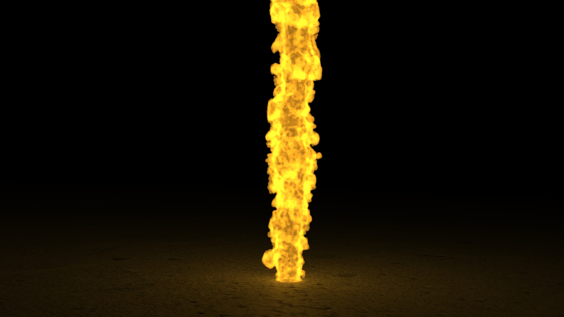

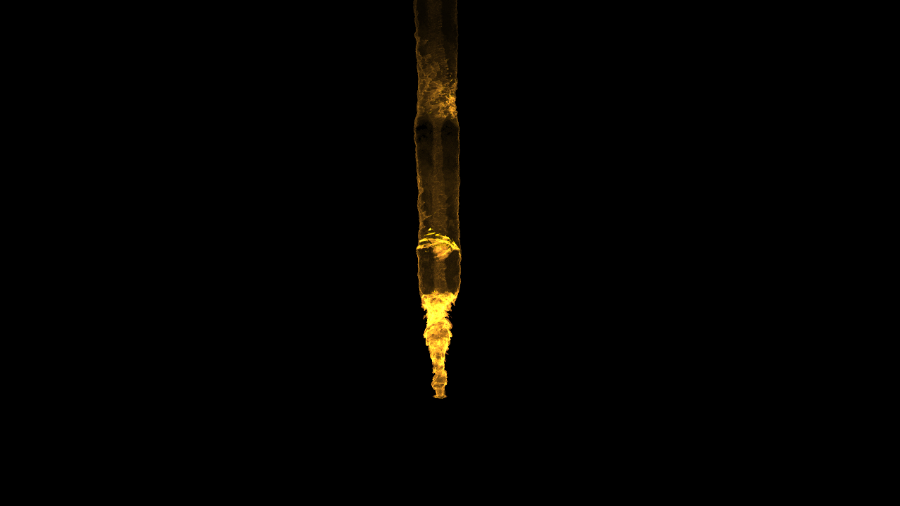

If you look at the attached images, there's an example of how it should look, and how it's currently looking. The physical size of the bottom part is perfect, and fits onto the model of the tent brought in from Blender perfectly. But then the fire expands out and almost looks like water, with a whirlpool or something inside. I would like the entire pillar to look like that bottom section. Any ideas how I would go about doing that?

A Pillar of fire is surely not a normal phenomenon. Lets call this an act of God where you are in control of the forces, gravity, whatever it takes. A non-physical approach is warranted. Need to create a long shaft of fuel emitting fuel and velocity.
See the example file with notes.
I just created a curve, then turned it in to a tube with velocity and then ran the smokeless fire tool on it. No look dev done at all other than to set up the heat ramp in the Pyro Shader to get you rolling.
Feed in any curve you want in to the network.
Note that you can also add the Gas Curve Force tool from the Container Tools shelf applied to the backbone initial curve if you want even more shaping control over the fire. To make it suck more along the curve if you want.

Hmmm that is very interesting.
In the Pyro Shaders, Smoke Field tab, you have to clear the Density Volume parameter, remove the “heat” field reference.
With that clear, you can render the shaft of fire and start the look dev of the effect.
Even though I set the density contribution of smoke to 0, the shader still calculates the field and forces mantra to cull opacity based on this field.
Removing it allows the fire to render as a pure emissive Ce object that uses no lights.
Apologize for that.
I updated the hip file in the above post and added a new test render with just the illumination through a volume light.
Note that I cut the resolution of the sim down by half. Go to the Pyro Object DOP and remove the *2 from the division size to sim at the original resolution. Adjust the sim resolution to suit your needs.

You may want to add a Volume Light to the Pyro Import object if you want this fire shaft to properly illuminate other objects in the scene.
Just select the pyro_import object then press the Volume Light tool from the Lights and Camera shelf. Now you can control the light cast from the fire shaft from this Volume light.
Fyi it uses pre-generated photons cast in the volume to act as many little light sources. No need to worry as the photon generation is set up to be automatic for every frame.

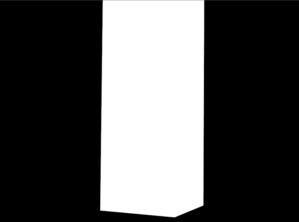

I'm having another issue that I can't figure out. My container is rendering solid white. I tried searching Google, but nothing helpful came up. Checked to make sure I wasn't viewing just the alpha, and I'm not.
