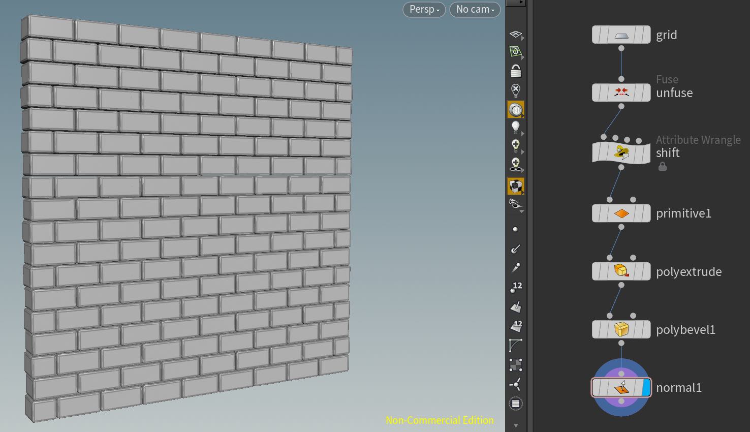

As you mentioned copy-stamping I attached an example, in this case an alternative route to create a brick wall. Instead of branching and noodling copy stamps, transforms, Hscripts and groups, you will find one sequence of discrete steps.
brick_wall.hipnc (77.4 KB)

I'd be curious to hear if a beginner finds VEX easier. Usually without the correct training the mind goes into a fog of disunderstanding.

Here's my take on the brick wall. Now that I'm excited about brick walls! I wonder if something like this [80.lv] is possible. Perhaps by applying layers of noise to the surface?
Edited by aoakenfo - March 25, 2017 18:14:55
brick_wall_2.hipnc (83.7 KB)

In case you get bored with rigid bricks you can also pile any kind of shapes by stealing UVs from the uvlayout node.
rock_piles.hipnc (103.2 KB)
28 posts
Joined: Nov. 2015
So the UV is used to evenly distribute the objects…awesome trick!
