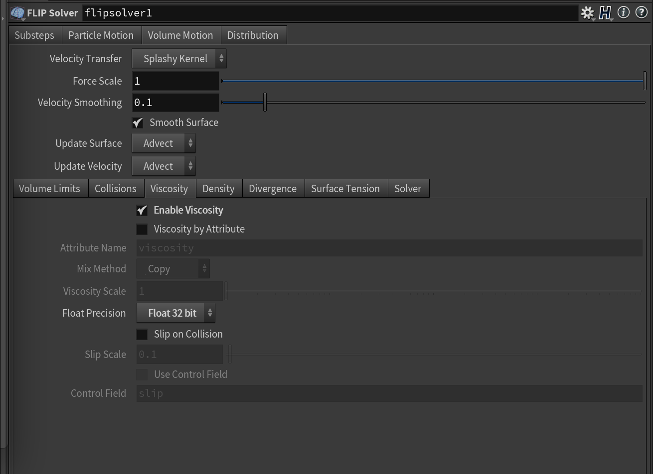

Hello Noboru,
I've tested the OpenCLtest.hip file on my MBP mid 2012 Nvidia650 and had to make the following changes for the flip fluid sim:
•Setting the Under-Resolved Particles method to No Detection turns off this behavior and should stop particle creep.
•Choosing Float 32-bit for the precision on the Viscosity tab will speed up the viscosity solver and is sufficient accuracy for most simulation.
•openCL appears to kick in when changing the from Float 64 to Float 32 setting causing the flipsolver1 error to disappear on my end. No slowdown or crashes as a result.
