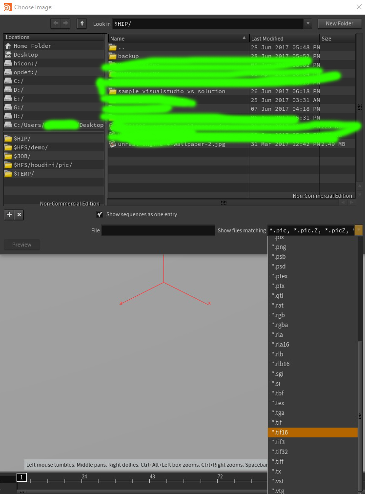

also if possible, where do I put the custom IMG_File object to show up in the editor? Having issues with that as well
I have two images below. trying to make the .raw file type appear, but it doesn't show in the drop menu for the textures still as well.

Next step is to figure out how to have the custom IMG_File class to appear in the drop menu when selecting a texture
