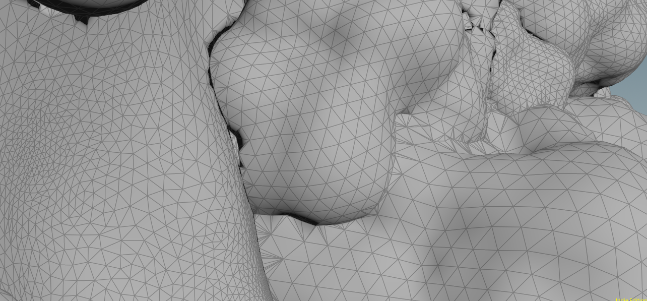

That makes sense, and takes care of half the issue. However I still do not get clean geo out of the loop. In the example file everything works, probably because the geo is very simple. In my actual production file I do not get it to work. What happens is that the boolean does its job insofar as making a union, meaning it merges and connects the meshes, but it does not delete the “inner” parts, and I need it to, because I have to scatter points on the surface of the resulting object (from the bool), and if the inner parts are still there the whole thing will grow inwards as well as outwards, which of course I don't want.
So do you, or someone else, know why this could happen? Does the boolean node only work correctly on very simple, convex geometry, or is there still a way to get things to work in complex cases?
I have attached a couple of closeups from my actual file to show what I mean.
