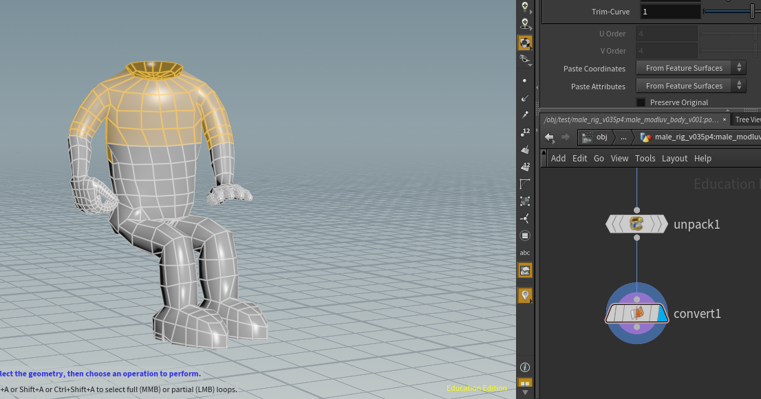

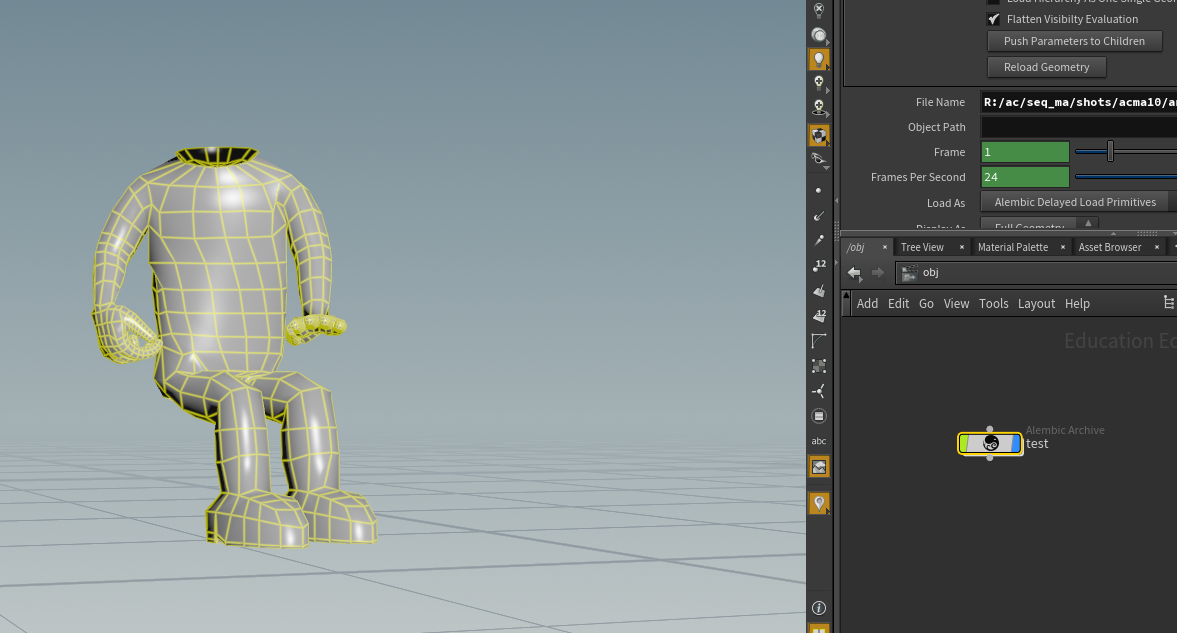

So I've been doing the exact same thing with my alembic as you did in your video. ( This is imported from maya, so could that be causing issues? ) But I've attached images and my steps were as follows:
AlembicError1.png: imported alembic into fresh scene.
AlembicError2.png: found the specific piece I wanted to edit (in this case it's the only thing in the alembic).
AlembicError3.png: Inside the geo node is the alembic file node.
AlembicError4.png: I added an unpack node.
AlembicError5.png: I added a convert node. ( I checked polygon on the information and it's saying that I should have all of the polygons for this geo 1,000+).
AlembicError6.png: I select the polygons I want to delete.
AlembicError7.png: When I press “Delete” on my keyboard I get the error.
