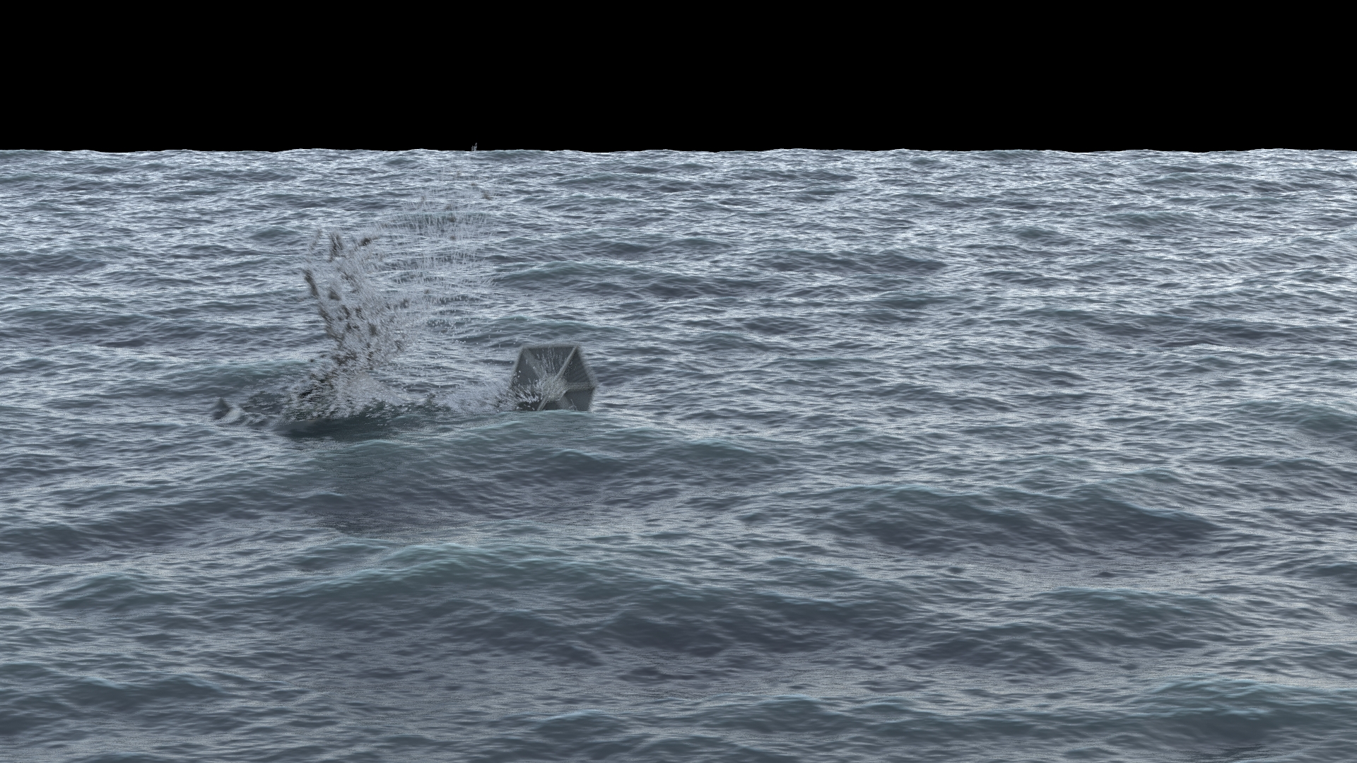

I recently got some whitewater issues with my FLIP simulation. I attached two pictures; I like the first one but I'am unsatisfied with the second.
As you can see the white water is just some white spheres stretched apart; is there a way to control this and make it look more real?
I already decreased the particle separation of the white water source to 0.025 and added motion blur, but no (visual) difference for the white water except longer render times.
So are there some clues to fix and manipulate this behaviour?

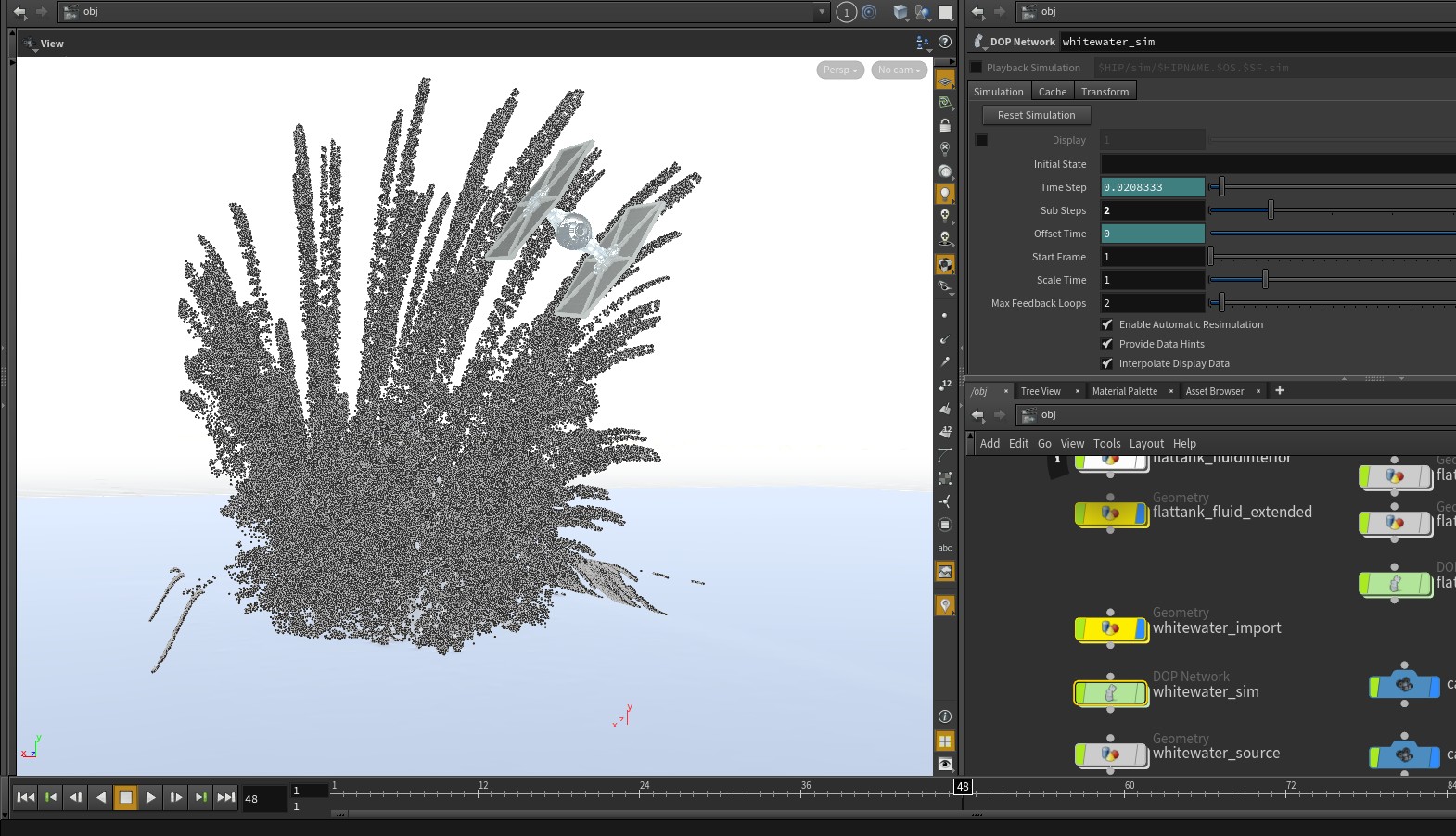

I'm still engaged in this issue and seeking help.
I increased substeps of the whitewater spray sim to 3 and also increased the impulse count too, to get more particles to fill the gaps. But as you can see, there are still gaps in the spr
ay render that cant be ignored.
So before going beyond 3 substeps I'm looking for other solutions here.
Additional there is a strange cut in the spray particles, and I don't know where its coming from; as the fluidtank and the corresponding whitewater shouldn't hit the boundary.

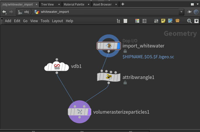

I noticed that you used a vdb for the spray. I transferred this workflow to my own setup and used the vdb for the spray and the particles for bubbles and foam. This seemed to work for me. The example from the houdini ocean masterclass didn't used vdbs for whitewater and I wondered why as your vdb-example worked pretty good.
So whats the difference respectively advantage for using vdbs for whitewater?

The funny thing is I did watch the H16 Ocean Masterclass video but my brain must have just *click default Ocean Flat Tank shelf tool* *click click more parameters* *click Whitewater shelf tool* and that's how I roll for my practice shots.
The VDB is part of the Whitewater shelf tool if you're referring to the above screenshot.
The VDB setup works together with Volume Rasterize Particles for rendering the whitewater and you'll find this in the Attrib Wrangle:
You can adjust the @pscale value to be smaller than 1 for more finer looking whitewater while the @v controls the amount of motion blur.
// Post-simulation tweaks @pscale *= 1; @v *= 1;
