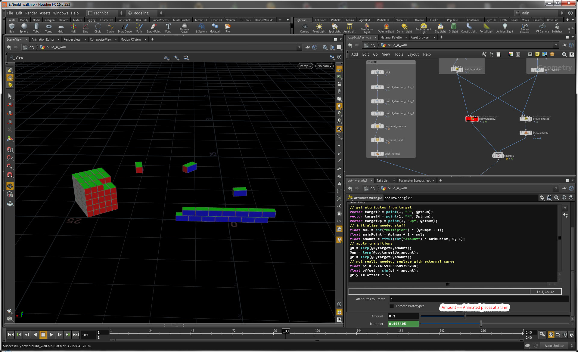

While working on a build from pieces project…
initial idea here:
“easy to animate moving points + direction”,
simple lerp expressions.
While working on it:
lerp gives sometimes strange results whn working with
positive vs negative vector values.
Working on offset curve from external splines now :-)
Maybe this is initial setup is helpy if you need to build something.
Simply play the animation to see what it is doing.
