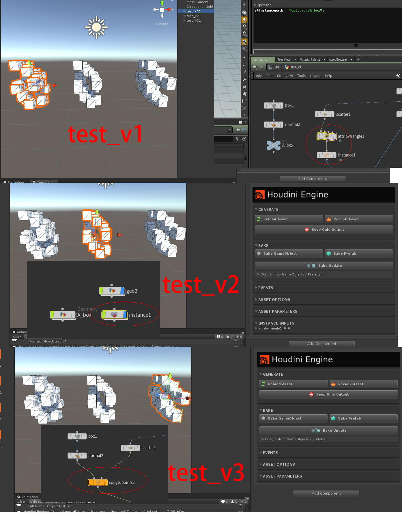

I've done three tests, and the problem is that collisions don't work when it comes to instance.As shown in figure. The enclosed HDA
test_v1.hda (30.2 KB)
test_v2.hda (22.9 KB)
test_v3.hda (27.9 KB)

There were some recent changes to packed primitive instancing with groups in the Houdini Engine that haven't been incorporated into the new Unity plugin. I'll update this thread once those are properly supported.

This should be fixed in the next daily build.

seelanv This should be fixed in the next daily build.thank you,so pleased
