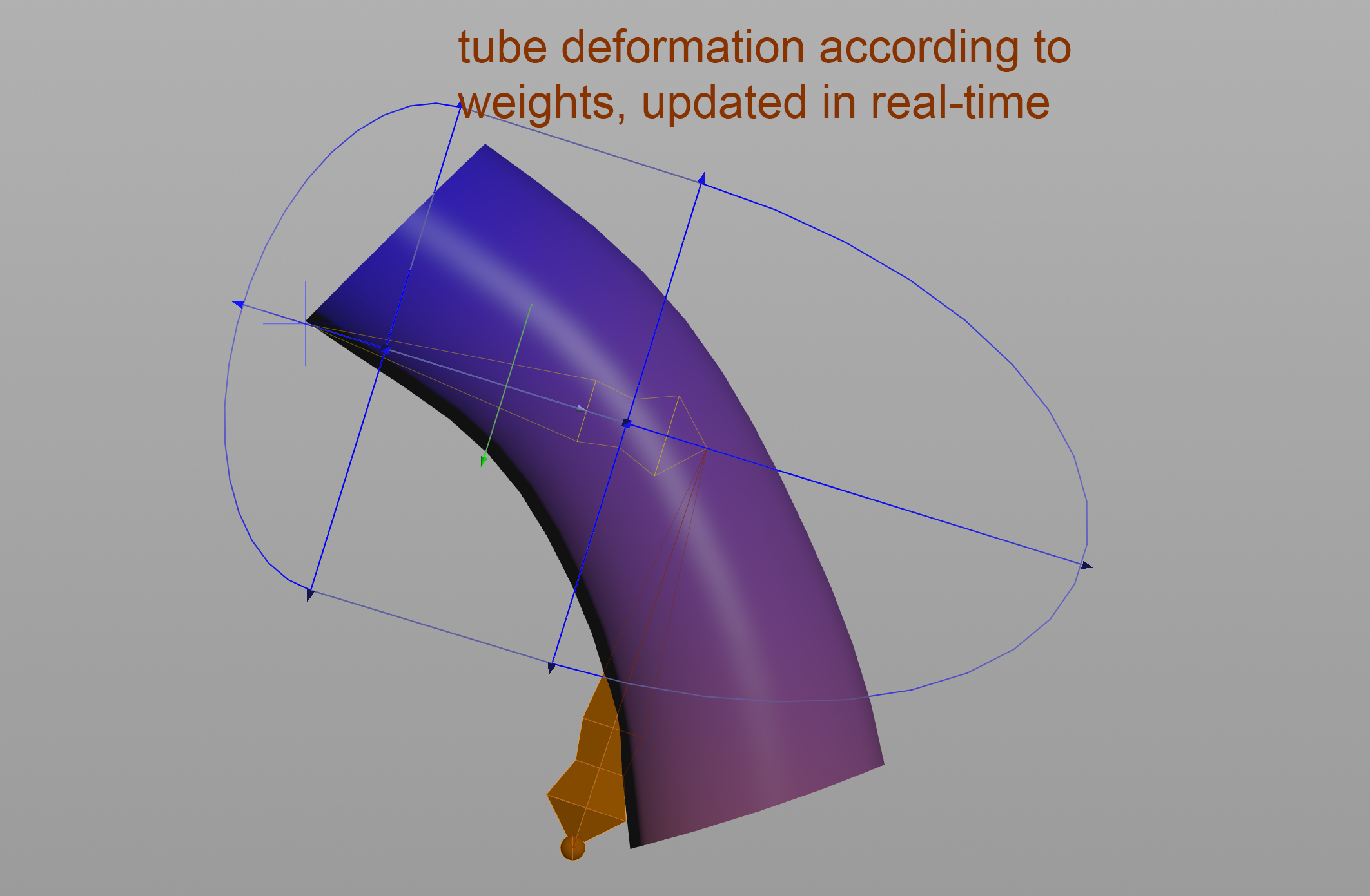

TristannnMcNistor
Editing bone regions after capturing in real-time (w/o recalculating “geo stash”), while also having a positive effect on the final weighting solution is possible only when you choose one of the other capture methods, beside “biharmonnic”.
Actually, this does not appear to be the case.
It's possible that I didn't understand what you mean or you did not understand me. Either way, I've attached two images with examples of biharmonic (1st trio) and proximity (2nd trio) behaviors when editing bone capture.
For biharmonic it's clear that changing a bone capture region will deform the mesh instead of changing the weights, which will of course have an impact of the final deformation, hence the slight change in point position after re-calculating.
In case of proximity, when I change a bone capture region, the affect on the final deform driven by the weights will be observed directly (in real-time).
This is what I was trying to describe. Isn't this what you had in mind?
What you're saying after that, might be true, I would have to analyze sentence by sentence with an example in front of me. Hopefully someone at SESI will understand it with less effort. Or you could roll-up your sleeves and show some image examples, because as you already know, it's hard sometimes to get exactly what the other is saying about technical issues and the saying “an image is a thousand words” never rang truer. Up to you.
