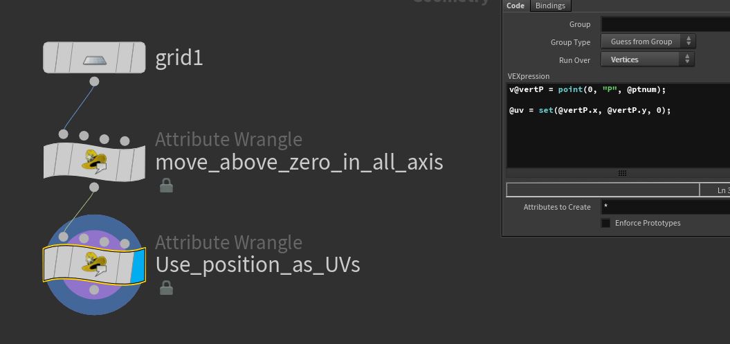

So, I moved my grid in positive values (in the 3D viewport) with this point wrangle:
…And transferred the point positions to the vertex UVs by using a vertex wrangle:
…Now, the UVs are perfectly from 0 to 1 just like in the 3D viewport!
-Olivier
vector min = getbbox_min(0); @P -= min;
v@vertP = point(0, "P", @ptnum); @uv = set(@vertP.x, @vertP.y, 0);
