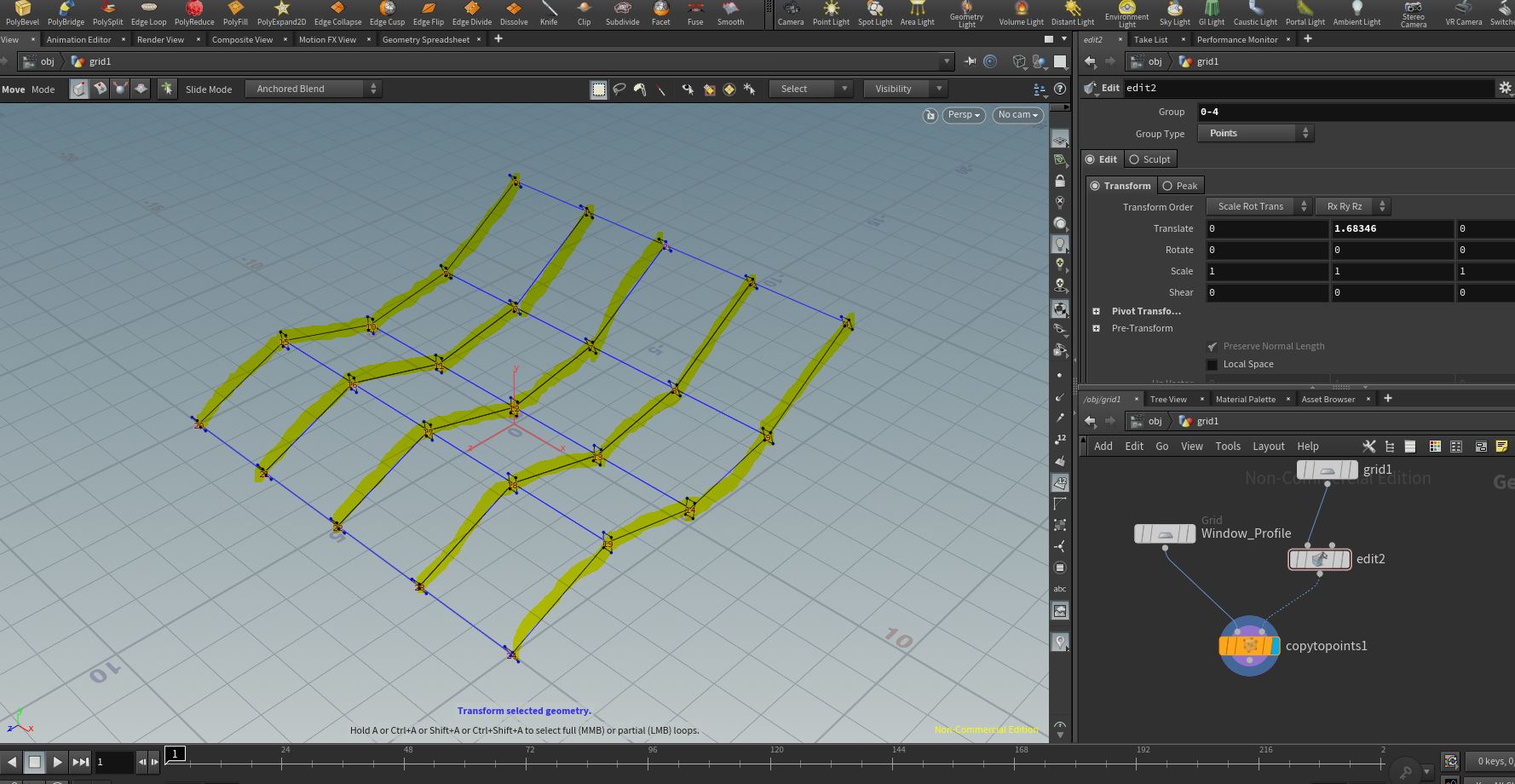

hi guys, Im new to houdini.
been trying to create a window mullion from a simple base geometry (Grid) and window profile (Primitive Plane)
so far I have managed to copy the window profile into the modified Grid points (see attached). but then I dont know how to “bridge” those primitives to form a vertical Mullion.
I have attached the screenshot that I made so far.
would want to make this a digital asset so that it will work on any form of grid that will be plugged into.
appreciate for the help. thank you

Hi, you could try the following;
- Add a Sort sop before copy. (example is sorted by X)
- Use a Skin sop after copy. referencing the number of grid rows for Groups of N.
- Add polycap at the end (optional)
If you can't directly use the Grid Rows as a reference, you'll need to figure out a way of calculating it.
Another option would be to use a sweep sop instead of copy to points.

Many Thanks for the great suggestion!
this work perfect for me
do u mind if I ask another question?1. Is it possible to create Group based on specific pattern in point numbers, for example:
