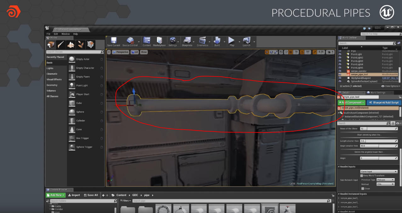

Hi there, before I go ahead and buy houdini, I was wondering if it had the same function for Maya as it apparently does for UE4.
The function I'm talking about is the ability to create a houdini asset,(ie. procedural pipe, staircase, bridge, wall, etc), and be able to extend it by dragging the curve or asset out farther, or add more point into the curve. This would be incredibly powerful for creating procedural building and sets on the production I'm on.
Thanks for the help!
https://youtu.be/gZ8BKE-QIp8?t=1146 [youtu.be]
Time stamp is included.
