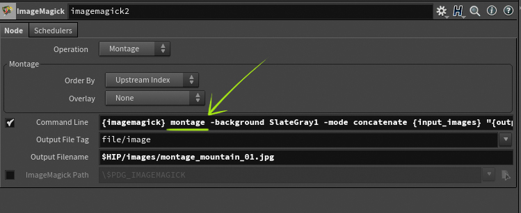

I have problem with imagemagick node with “montage” operation.
It fails when cooking and gives me the log below.
magick: no images found for operation `-mode' at CLI arg 5 @ error/operation.c/CLIOption/5332.
Executing command: “/usr/local/Cellar/imagemagick/7.0.10-13/bin/magick” -label ‘mymontage0’ -background black -mode concatenate “/Applications/Houdini/Houdini18.0.416/Frameworks/Houdini.framework/Versions/18.0/Resources/houdini/help/examples/nodes/top/imagemagick/terrain_images/inputs/ridges-inputs-001.png” “/Applications/Houdini/Houdini18.0.416/Frameworks/Houdini.framework/Versions/18.0/Resources/houdini/help/examples/nodes/top/imagemagick/terrain_images/targets/ridges-targets-001.png” “/Users/akira/projects/learning_PDG/images/imagemagick10.jpg”
I am trying with the official example scene.

I followed your plan:B idea and think I found a kind of solution.
Here it is.
Add “montage” command in the node's Command Line after {imagemagick}.
I've tried the command in the terminal with same failure and error messages.

As using a macOS I define “PDG_IMAGEMAGICK” to “magick” which is an UNIX executable(command?).
PDG_IMAGEMAGICK = “/usr/local/Cellar/imagemagick/7.0.10-13/bin/magick”
And apparently this “magick” command (new in ImageMagick ver.7) alone doesn't operate montage.
One more thing.
I also need an additional “composite” command in the Command Line for “Composite” operation.
I'm pretty happy finding a solution, but I still don't understand what is going on.

Hi Akira,
Glad you found a solution for now. The reason for this is that Imagemagick may be invoked in different ways depending on which installation of the program you are using.
For example, in some installations you call magickdirectly, and specify the subcommand as an argument:
magick montage
magick convert
In other installations, you call the subcommands directly:
montage
convert
I believe that some installations also support both. It looks like the first mode of operation is not being handled on MacOS (invoking the subcommand as an argument to magick. I will file a bug for this. I will also file a bug to update the node documentation with more clarification about the different ways that Imagemagick can be invoked.
Are you able to call the subcommands directly with your installation? If so, the easiest setup would be putting the Imagemagick binary folder on your system path.
Lastly, there will be some work done on the Imagemagick node to make this easier and more seamless for the user.

In order to make things easier on Mac, I've added support for a PDG_IMAGEMAGICK_DIR variable. Instead of setting the PDG_IMAGEMAGICK variable, please set the PDG_IMAGEMAGICK_DIR variable to the location of your ImageMagick binary folder (e.g. ~/imagemagick/7.0.10-14/bin). This will allow the node to find the executables of all the various subcommands (convert, montage, etc.).
This fix will be available in the next Houdini daily build of 18.0 (18.0.481 or later).

I tried your instruction with the latest daily build (18.0.484),
and it works fine!
Thank you very much for all of your support.
