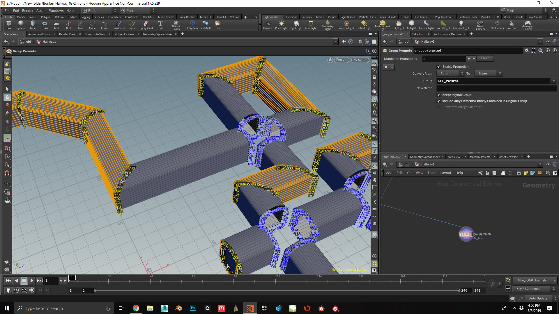

How can i the points i have in my group and convert them to edges i did this with the Group Promotion SOP somewhat works. But i just want the edges going around the points in the group not across.

Are you using a sweep to generate those shapes ?
If so you can add an ID on the point of the backbone curve, and use the partition to create a unique point group by ID after the sweep, promote those point groups a edges groups, and collect them into a single edge groups with the group combine operator.

Cool Thank you for the help it works just how i wanted too.
