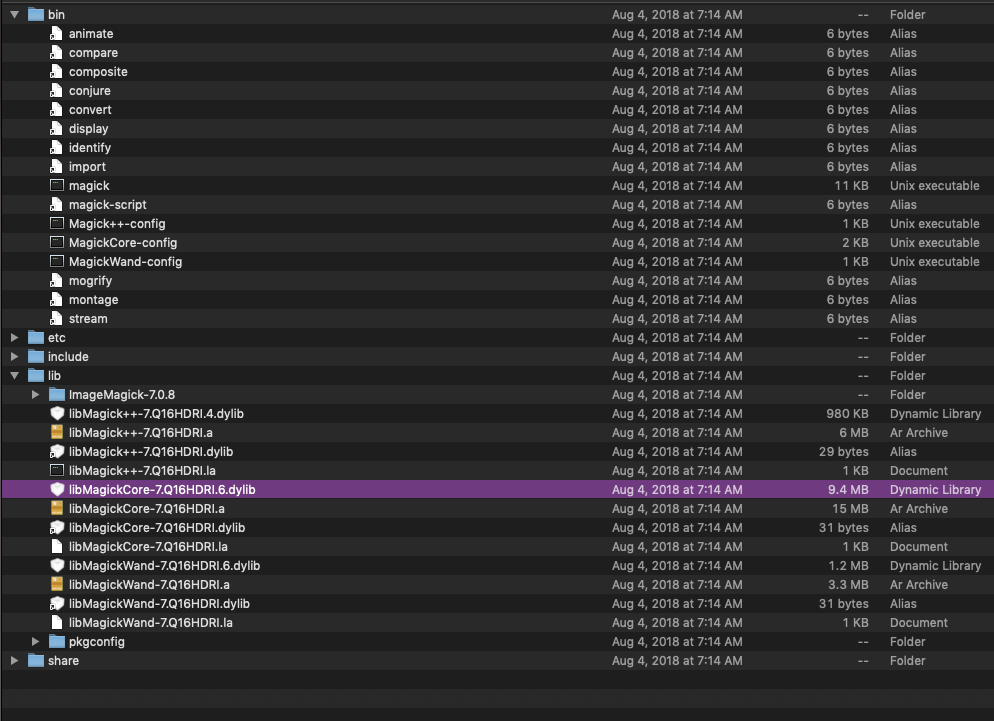

225 posts
Joined: Nov. 2010
Screen shot of file structure on my end
ScreenShot 2019-08-06 at 9.15.20 AM.png (221.5 KB)

399 posts
Joined: Aug. 2017
Can you try this amended command from your Terminal:
“/Applications/ImageMagick-7.0.8/bin/montage” -label ‘mymontage1’ -background black -mode concatenate “/Applications/Houdini/Houdini17.5.293/Frameworks/Houdini.framework/Versions/Current/Resources/houdini/help/examples/nodes/top/imagemagick/terrain_images/inputs/ridges-inputs-001.png” “/Applications/Houdini/Houdini17.5.293/Frameworks/Houdini.framework/Versions/Current/Resources/houdini/help/examples/nodes/top/imagemagick/terrain_images/targets/ridges-targets-001.png” “/Users/io/Projects/PDG/images/imagemagick11.jpg”
225 posts
Joined: Nov. 2010
Same, no such file or directory.
399 posts
Joined: Aug. 2017
Is it definitely installed at the location in the command? It seems that the location does not exist.
If you can, I would recommend filing a question or bug with support and we can continue investigating your issue from there.
