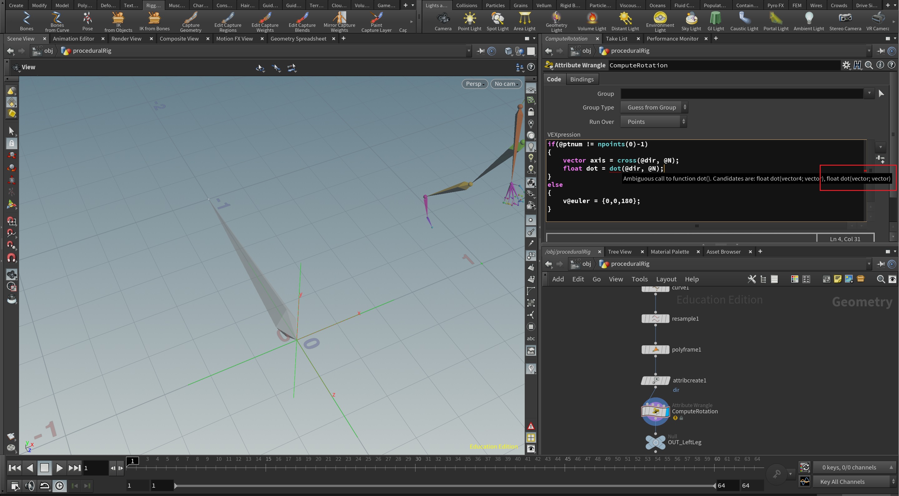

I'm getting a weird issue over here. In my point wrangle the first line works, the second doesn't.
vector axis = cross(@dir, @N); <- takes two vectors, works
float dot = dot(@dir, @N); <- takes two vectors, fails
Am I missing something horribly obvious?

try v@dir
It's good practice to always specify the type of the attribute that you are referencing from the geo, when the attribute is not created in the same wrangle.
Houdini would assume it is a single float attr otherwise.

Thank you very much, now it works. It's just very confusing that you can explicitly set the dir-attribute in the “attribute create”-SOP as a vector but then have to type v@dir, while @N works without specifying that it is a vector…

@N, @Cd, etc are a public/known attributes, so no need to do the formal presentations to mr. Houdini every time.
If you created a v@myVect in a wrangle, you can use @myVect afterwards in the same wrangle.
