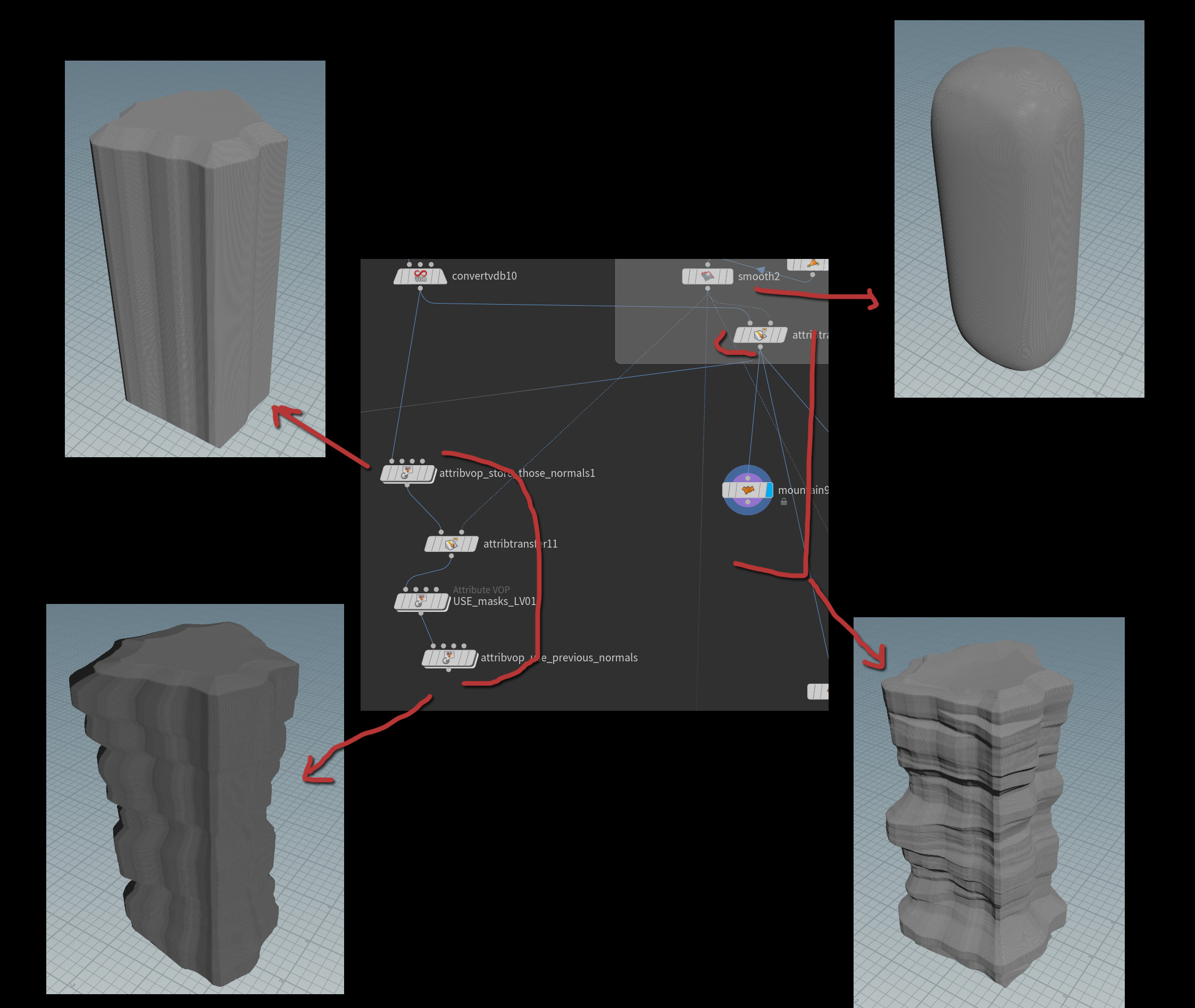

I have to apologize because i forgot to mention i'm using a tricky normal transfer because of the good displacement results.
I attached a picture that shows what is my problem.
When i’m using mountain node it gets the normals of A at shading, but gets the normals of B to the displacement
I have to define somehow the normals of A and give it back in the second attribvop (where the actual displacement is happening) to get “proper” normals to shading.
But important to use the normals of B at displacement (unified noise) in the attribvop to get good displacement result.
I could save You time if i mention it sooner, but i was not sure if it's important or not!
A big Thank You again and also thanks for the answer in advance

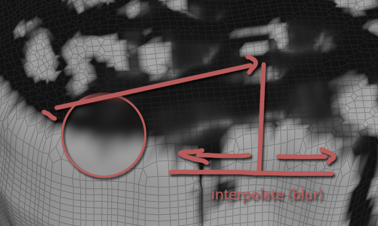

1-How can i “blur”/interpolate my color masks? i see there is space to play with ranges to get a more soften/hard result, but sometimes it would be good to get a simply blur or interpolation kind of thing.
2-Plus i'm trying get over color information from one attribvop “level” to another (shot attached), but i only get the bias “mask” of the color mixer. Is there any way to “recall” also the colors, not just the “bias mask”?

1195 posts
Hey!
For your first reply, don't you just place a normal sop at the end? But if you really need to use the same normals you had before, you could simply use a “bind export” node in your previous VOP. It allows you to store attributes that you can later “recall” with a “bind” node.
For blurring the mask, you could soften it with the fit range but to get real blurring, use the attribblur sop.
For the last question, you can store as many mask as you want with the “Bind Export” node in vops and get them back with a “Bind” later. You can check the attached file.

It's only an inconvenience but would be much better to get access to attribblur (or some kind of blur) right at the mask creating “ ”space“ (in vex builder)
Now i have to separate every mask i want to blur into different attribvop nodes to able to connect them into an attribblur (at least i didn't figure out how can i use bind_export in the attribblur. (shot attached)
Bigger problem is that i can't see how can i use both the normals (mesh A and B) within one ”connection line“ (or how we call a connection stream in Houdini) shot attached
To this problem, my question is how can i get normals from mesh A (plus the masks are binded from the same “connection line”,
but get normals from mesh B to proceed the displacement vectors right
i need somehow to get both (mesh A and B) normals, but once i have to use mesh A normal to get proper shading (plus i need the masks from mesh A) and at the “same time” i need mesh B normals to the displacement effect.
I guess somehow i have to merge the two connection line, and i have to store somehow both the normals (mesh A and B)
Or maybe i just need the normals of A but i still have to merge my ”mesh A ward“ with ”mesh B ward" because i need the detailed mask to use with the smooth normals/position in displacement.

1195 posts
Can't your attribtransfer be just before your displacement? That way your detailled mask would already be created before transferring the smoothed normals for your displacement. And it would all be in the same connection line.
Also, an easy way of having smoothed normals is to use an attribblur set to "N" instead of the attribtransfer trick.
For the last image, the sphere has 2 attributes: @color_to_blur and @Cd. Your attribblur IS bluring @color_to_blur but you are looking at the sphere with @Cd. You would need another VOP where you would use a Bind to pick your @color_to_blur and connect it to the Cd. That way, you can see the blurred result.
